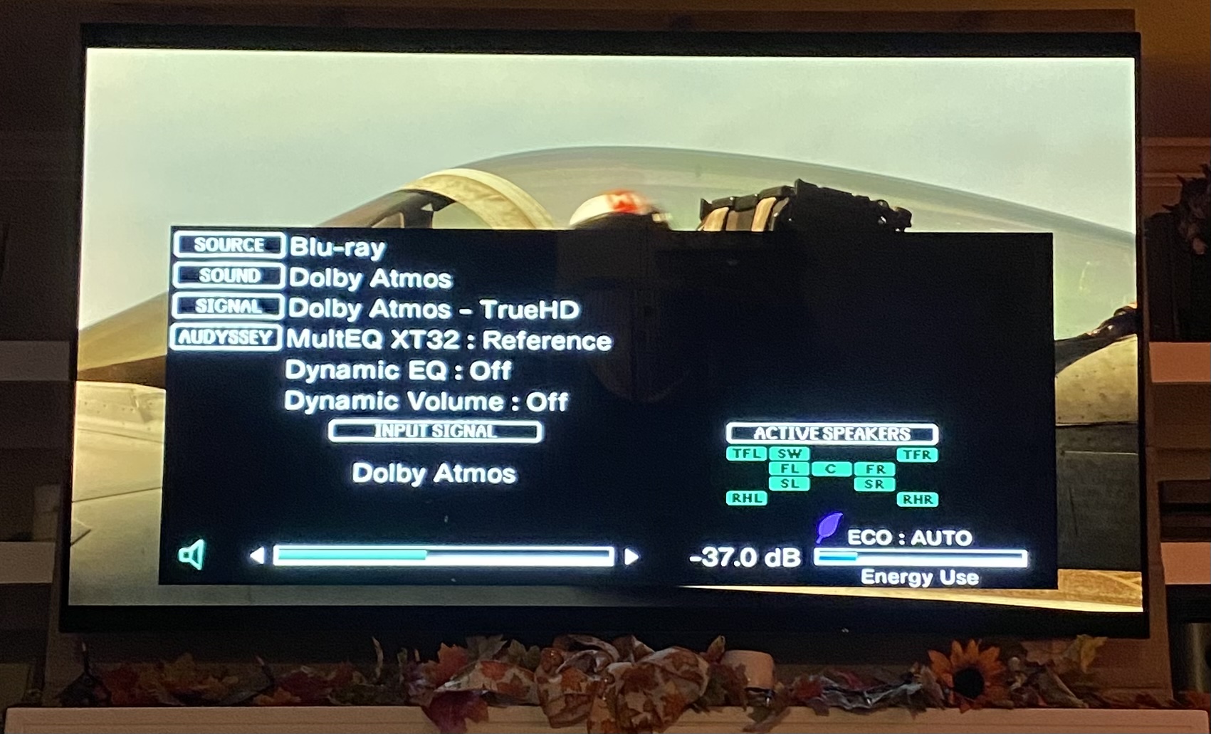

Why does it say TrueHD with Dolby Atmos? Is it my speaker setup?
Toy Audioholic Intern Oct 31, 2022 #1 Why does it say TrueHD with Dolby Atmos? Is it my speaker setup?
lovinthehd Audioholic Jedi Oct 31, 2022 #2 Well Dolby Atmos is metadata on top of TrueHD essentially so assume that's why your signal shows such, and if you don't have the ability to play Atmos you'd get just True HD. You're playing in Atmos, tho.

W Wardog555 Full Audioholic Nov 1, 2022 #3 yes it's your speaker setup which I assume includes height or ceiling speakers?
William Lemmerhirt Audioholic Overlord Nov 1, 2022 #4 As hd said, trueHD is the container for Atmos. It will still say that on the input side even without an Atmos setup(which I see you have) but the output will say Dolby surround, or dts neuralX etc.

Toy Audioholic Intern Nov 1, 2022 #5 Wardog555 said: yes it's your speaker setup which I assume includes height or ceiling speakers? Click to expand... Yes I do have four height speakers

lovinthehd Audioholic Jedi Nov 1, 2022 #6 Toy said: Yes I do have four height speakers Click to expand... If those are enabled, it allows you to play Atmos....if you turned those off your avr would play just the TrueHD core.
