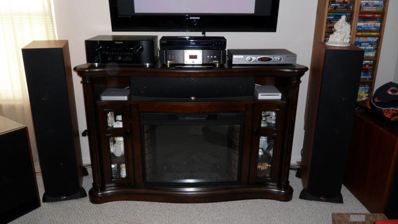

Well, even if off 12db, that's still 112db, I'm not here to brag, but if they're off that much why are they so highly recommended?
The system is a Marantz SR5003, Klipsch RF-82's and dual MFW's in two corners of the room.
Here is a 6 year old picture, the speakers and subs haven't changed from when I took this. The rest of the gear, like the Blu-Ray, TV and DVR have been replaced.
Here is an even older picture, but it shows the placement of the subwoofers properly.
