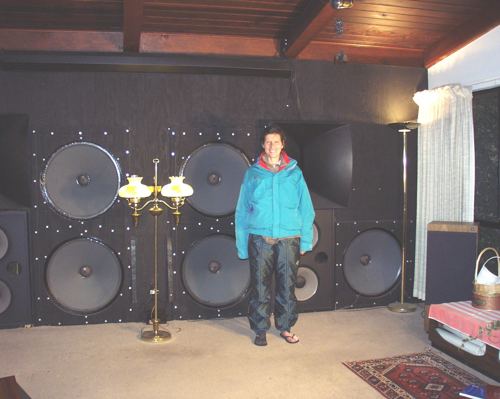

Wow, those speakers are a monstrosity. Seriously, I could see them scaring children. Just looking at them makes me a bit uneasy myself. Those are speakers I would describe as 'Lovecraftian.'
j_garcia
j_garcia
They look like giant nightmare frogs lol. Even if they sounded spectacular, I don't think I could handle them.
Hetfield
Wow, just wow. No way I could deal with that. It looks like something out a clockwork Orange.
Sent from my Pixel using Tapatalk
William Lemmerhirt
William Lemmerhirt
Holy $hit!!! I love big ugly speakers but nope. They look like a twizzlers commercial.
MrBoat
I kind of meant like big ugly normal looking speakers. Those things are just vulgar looking, in a violated kind of way. That's a lot to go through, for an audiophile fix. The more I see the extremes, the further I remain planted in the more simple approaches.

As you know these speakers are large, and you can decide if they are ugly. However they are truly full range and high spl. They produce a very deep depth of field and the sound is not up and close and in your face. There is plenty of detail.
They are "impressive" looking. I don't really think speakers are really attractive except what the aesthetic represents with regard to performance or the engineering that goes into them. Either way, you did a fine job integrating them into your room.
My Tempests are kind of industrial or, perhaps even menacing looking, but I like the looks of them either way. These speakers look like they would be in your face but are rather refined sounding, for lack of a better explanation.
Oddly enough, the women that have seen them think they are "gorgeous" and I know some brutally critical bitches.
You ought to hear them. I had a pair of the big woofers, in corner-loaded cabinets- they had originally been used for the bass pedals of a church organ and if I could have gotten them into the basement of the house I bought, I definitely would have kept them.
