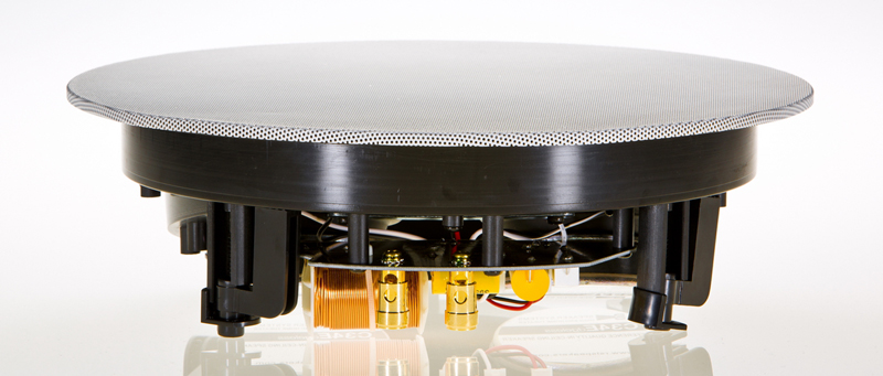

Finding IW and IC FR measurements is very difficult.
Mark, these are what I chose for my front and rear Tops.
It’s more of a preview, than a review but RSL did include a polar response graph. I’ve been very satisfied with them and tried them as mains in my bedroom 5.1.
I know you’re loaded down these days but thought I’d share. FWIW, RSL designed these with the baffle structure to avoid exactly what you said about diffraction and the tweeter mount being in the way. Another reason I liked them.
