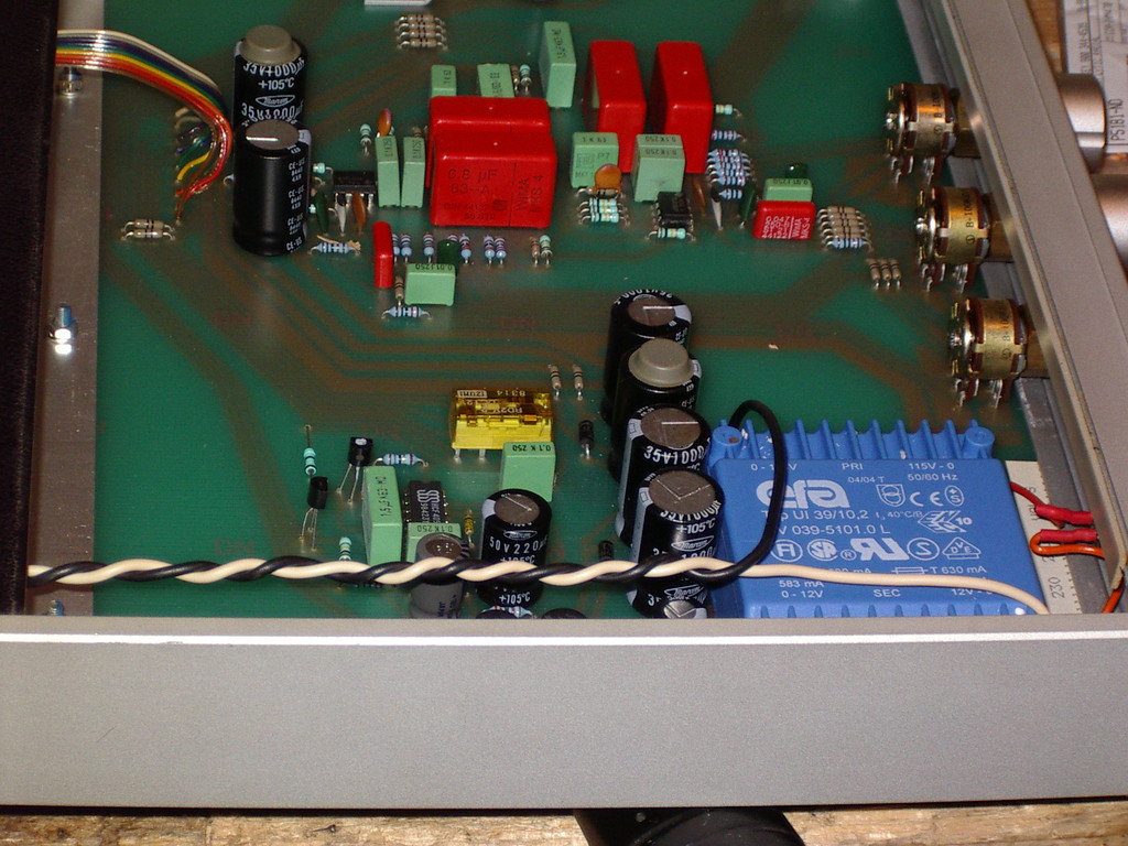

The trouble is we do not know the spec. There are multiple pin outs on his old transformer. So we do not know how his was configured. In other words we do not know the voltage of all the taps, and if there are any center taps.
This job is not always easy. Here are pictures of a transformer replacement I did on a friend's preamp, that fried the transformer.
Old transformer photographed with replacement.
View of new transformer in place. There were 12 and 5 volt taps and center tap.
And the reason we do not know these things is the OP's inexperience. I hesitate to offer pointers to determine the values, since I am not confident he would survive the attempt.
