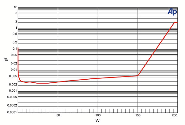

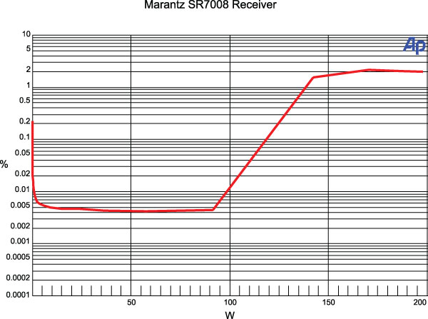

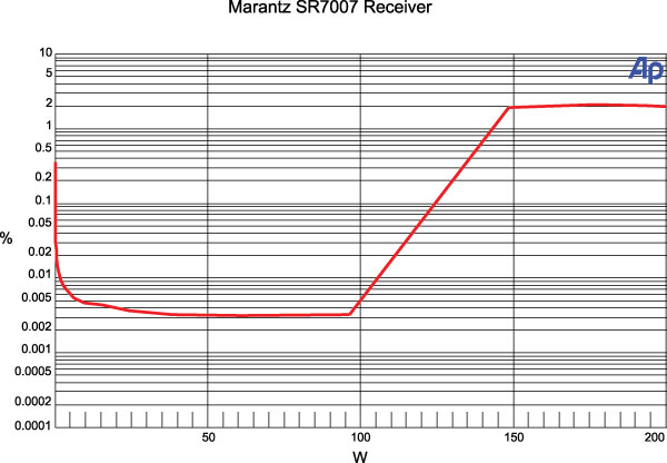

For those interested in S&V bench tests, below is a comparison between the SR7005 through 7011 and the Denon AVR-4520CI. I got some of the facts in my post#58 wrong, but below are taken directly from S&V website, not from my memory.:D
It seems that the Marantz flagship units performed quite consistently on the S&V bench over the last 7 or 8 years, typically a notch or two below the Denon flag ships in terms of 2 channel driven output power into 8 and 4-ohm, 5 and 7 channel into 8-ohm.
At 0.1% distortion:
SR7005:
2 Ch - 121.5W 8-ohm, 200.1W 4-ohms
5 Ch - 91.2 W
7 Ch - 74.6 W
SR7007:
2 Ch - 124.3 W 8-ohm, 205.1 W 4-ohm
5 Ch - 89.5 W,
7 Ch - 70.5 W
SR7008:
2 Ch - 122.5 W 8-ohm, 195.4 W 4-ohm
5 Ch - 101.2 W
7 Ch - 68.8 W
SR7010:
2 Ch - 128.7 W 8-ohm, 201.7 W 4-ohm
5 Ch - 84.3 W
7 Ch - 83.2 W
SR7011:
2 Ch - 138.7 W 8-ohm, 203.5 W 4-ohm
5 Ch - 104.9 W
7 Ch - 75.1 W
AVR-4520CI:
2 Ch - 172.6 W 8-ohm, 237.5 W 4-ohm
5 Ch - 121.8 W
7 ch - 108.8 W
