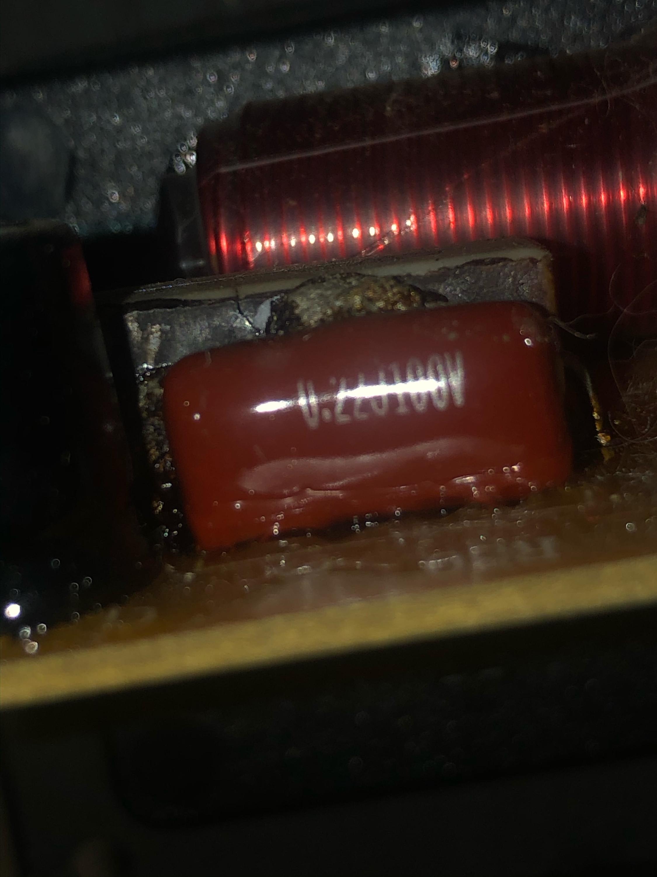

Maybe 0.22J100V actually looking back a it. Is this a resistor or capacitor?
0.22 microFarad capacitor rated at 100 volts. Those ceramic capacitors are tough and likely not damaged by the burnt out resistor. The black one in the corner is an electrolytic capacitor. The casing usually bulges out when they go bad. I don't see any physical damage on it. Likely just the resistor burnt out.
Look at the top of the cap- the lines aren't straight, so it may be 'domed'. They should look straight at any angle.
Hard to tell from that angle. Need a side profile. The value is written on the side. If Benni777 decides to replace that cap as well, keep the polarity the same. There is a white line on the bottom side in the photo and the replacement should be installed with the same orientation.
Not really- if the top of the cap is actually flat, the lines will be straight from any angle. I don't see a straight line.

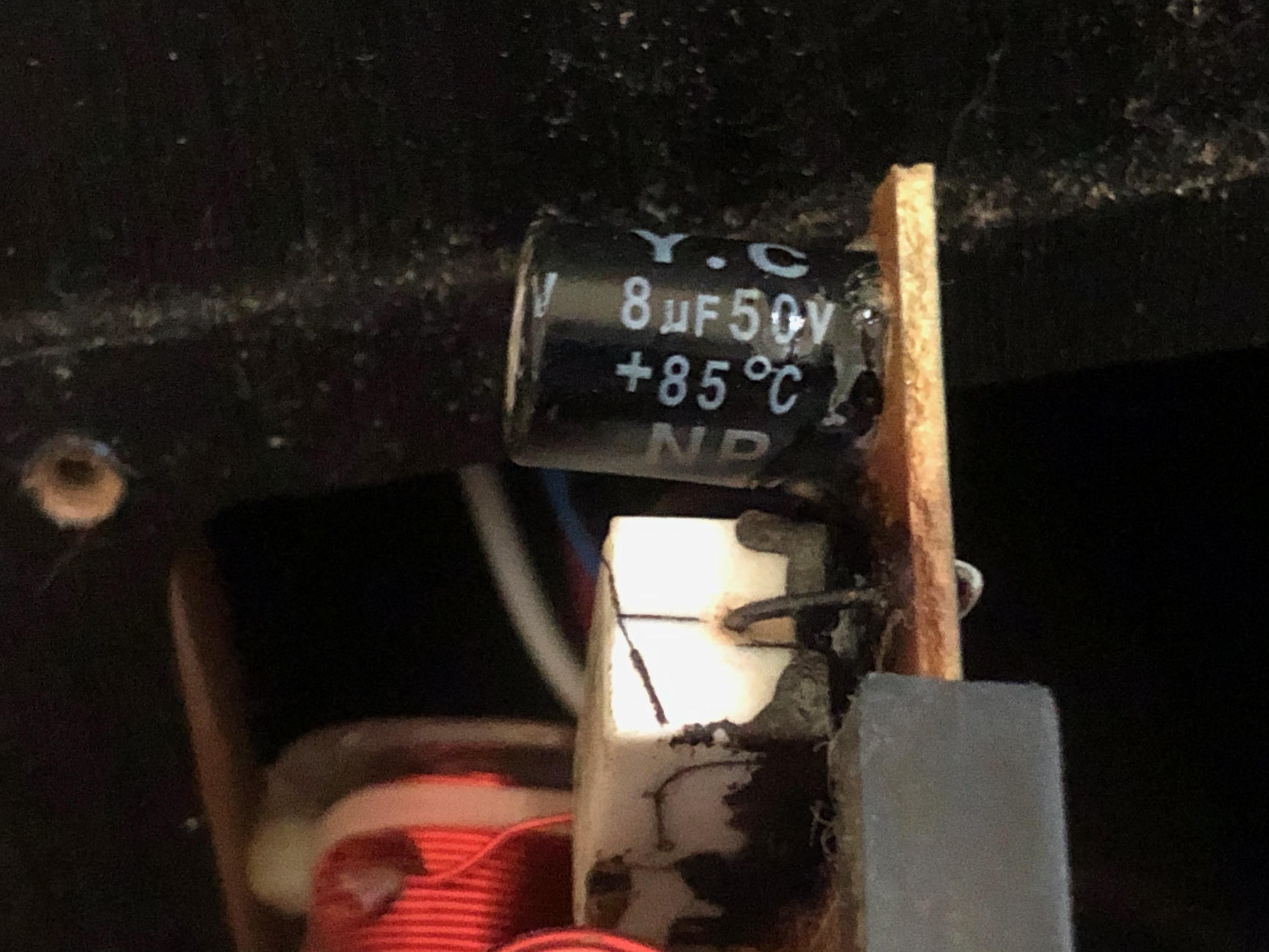

Late on the reply, but here is the cap. Looks like. Y.C 8uf 50v. 85°. But I could use any cap as long as it's a non polarized 8uf 50v electrolytic capacitor???
Benni777
Benni777
Oddly enough, I can't seem to find these exact components.
5 watt 2.5 ohm resistors
8 uf 50v capacitors
I find near values but not sure how that would affect the overall sound and or quality. Or if it would even work???
Thoughts?
8 uf 50v capacitors
A general rule of thumb for crossover parts is that any part within 10% of the specified value can work. For a 2.5 ohm resistor, ±10% puts you in the range of 2.25 to 2.75 ohms. This 2.4 ohm $1.41 resistor should work:
Or if you want to splurge you can pay $1.69:
Both resistors are rated 10 instead of 5 watts. Those wattage ratings are failure ratings. A 10 watt resistor will handle more power than a 5 watt resistor. It will not affect your crossover to substitute a 10 watt resistor.
For an 8 µF capacitor, the same ±10% rule of thumb applies. Going higher than a 50 Volt failure rating, helps with the power handling, but doesn't affect it's performance as a capacitor. Here is an inexpensive non-polar electrolytic 8 µF rated at 100V. I hope that fits in the small space available. It can be mounted vertically.
Awesomeness, thank you soo much this is helpful. I am a noob I know but am learning as I go. This will help as I will be attempting a DIY 5.2.? Soon

We ended up ordering everything we needed and rebuilt the XO. Works perfect now thanks to everyone on here.
