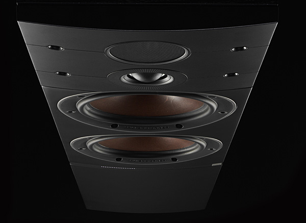

First of all there are no stupid questions... Well you should know the rest. That being said, there are quite a few powered bookshelf speakers, the KEF LS50W first and foremost in my mind. As far as Tower of Power speakers, Dynaudio, Dali and Elac all have them, Elac falling right in your $5K area:

Buchardt has an active tower releasing soon called the a700. If you’ve never heard of Buchardt check them out. You can find many measurements of their s400 passive bookshelf speakers and a500 active bookshelf speakers. Even the bookshelves are 3 way.
If you don’t want to pay Dutch and Dutch 8c money. Those Buchardt a700’s are going to be the ticket.
