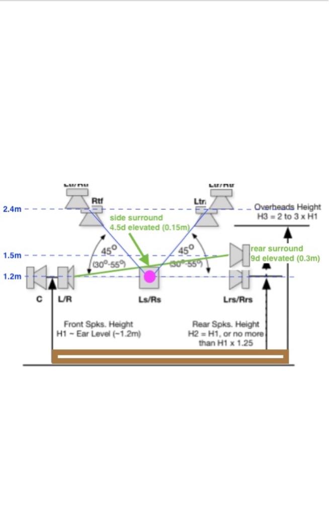

I would take the higher number. Having the surrounds too low is a mistake. The reason is localization. You don't want to localize to to the surrounds. If you get them too low any seating near the surrounds, will localize and that will be a bad seat. You have to be careful if you have a tiered theater. You really do need to keep the surround's tweeters 5' above the floor at that location. I can assure you that a tiered theater can not be tied to the mains tweeter height, which ideally should be at 36".
Here is a picture.
The tweeter heights of the surrounds and rear backs, are 60" above the second tier. If they were lower then those second and third rows would localize to either the surrounds, rear backs, or both at times.
You really don't want any seat to localize to any speaker ever. If you do the sense of space and illusion is lost.
My advice is that if in doubt choose the higher level. It will be the safer bet.

i only have one level of seating, ear height is the same for everyone.
I agree about the localization for sure i don't want it to become an issue however with the single row of seats and one ear level i am trying to get the best performance possible engineered out of my setup
i will take this into consideration and maybe raise them slightly from the 1.25x mark
Thanks !

FWIW. I think I ended up with 55-60”. Don’t have a tape handy...but I believe I was 39” times 1.55.
In any case, I forgot to ask what is the ceiling height?
William Lemmerhirt
William Lemmerhirt
Ok. That’s like 7’-3”. Not very high. Ime going too high with the surrounds won’t allow enough separation between the bed layer and height layer. IMO that’s important.
Cheesehead85
Cheesehead85
yeah good point, makes sense
seems like the 1.25x is a good sweet spot for me
that puts me at 50”, maybe i’ll up it too 52” which is 1 foot above the fronts tweeter/ear height
