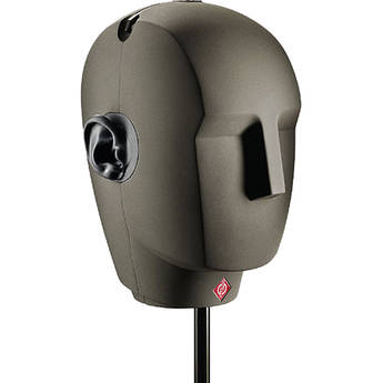

You have to elaborate. You can't just post a picture.
Looks like he is saying that a dummy head binaural mic rig can emulate human hearing, but that, of course, is not the case. Even if you had a full torso binaural rig, mic capsules are still too different from inner ear mechanisms to replicate what they are doing. And even if they could, ears are attached to brains, and brain processing determines so much of what we hear beyond the physical stimulation of hair cells in the cochlea or signals going through the auditory nerve. even the most sophisticated torso mic systems are crude in comparison.
Well I didn't want to put words in his mouth, but what you say is right. A dummy head isn't an equal stand in. The main issue I was getting at in the article talks a lot about the processing piece. As you know, I went down this road myself. I took an inexpensive Dummy head binaural setup I had and took dual channel sweeps of my speakers. Within REW you get nothing useful (and the inaccuracy of the response of that measurement makes it useless for EQ purposes). Then I scratched my head to figure out what to do with this new found data. Eventually, I was able to create binaural impulse responses, difference responses, and calculate some binaural room parameters. It still wasn't possible to use that data to calculate anything related to the speaker's recreation of an image, spaciousness, or envelopment.
I then engaged David Griesinger, and that took me down another rabbit hole. I eventually came up with more analysis of the data I had captured (all of it outside of REW, I had to use Matlab-OCtave). Most of it still told me only information about the room and not the speakers. I tried doing some analysis of panning, but going back to the psychoustics issue, it wasn't possible to make sense of the data. I could measure the movement of an object through a series of measurements across the azimuth, but I couldn't tell if it was good or bad.
There is also 3D impulse responses, another rabbit hole of in-room measurements, but again. Doing this requires an expensive microphone and either sophisticated software or an ability to code it yourself. This is getting far closer to what is needed to make sense of a system in-room, and it's also getting farther away from anything the average person can do.
