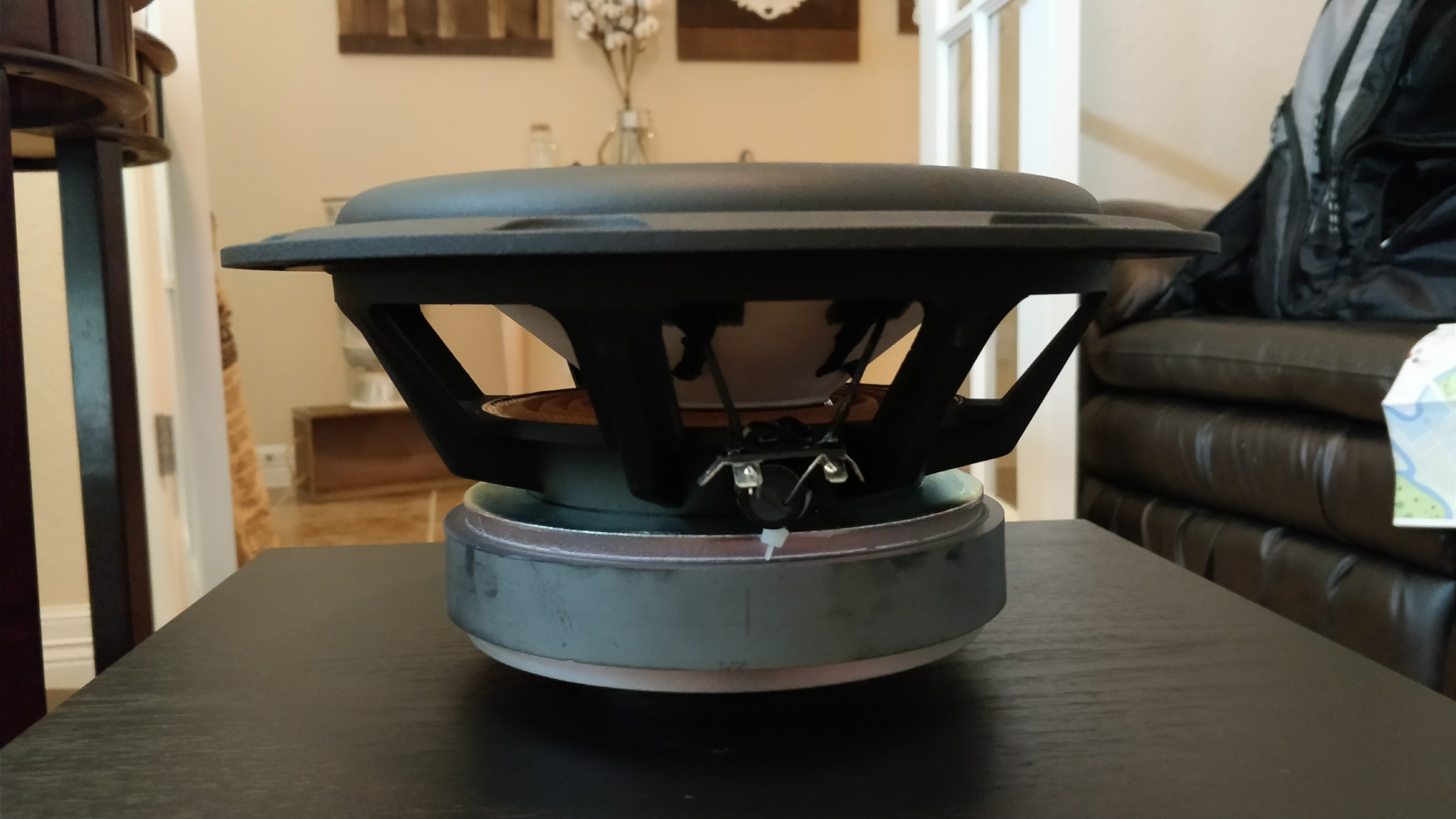

I am pretty sure I saw a pic of the SUB1200 driver (maybe Jman had posted - his photos are no longer up) and the magnet and frame were not at the same level as the JBL

I'll have to measure what DB level I'm at when the driver starts to vibrate internally. Then I'll be able to say what it's "normal" listening levels are. I think I'm asking it to do too much, but 90% of the time it sounds excellent. It's just those times I'm asking it to do 30hz and below at "loud" listening levels that things get noticeable. Normal music listening doesn't affect it at all until loud/deep bass appears.
EDIT: Just did it and at the MLP at 30hz test tone it vibrates at ~83db output.
Oh, I was thinking this was a new problem! So what you are saying is you recently demanded more from your subs which revealed a weakness that was likely always there?
I'm thinking so, but it's hard to tell since I really only listened to music in my office. We just started watching more TV in my office so it became more noticeable.

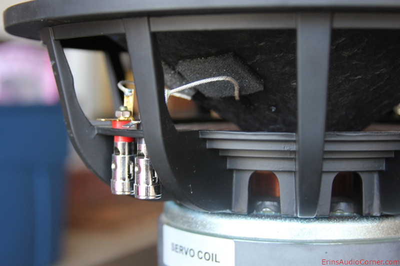

Hey!
I was just checking out @ErinH 's site and reading about the Rythmik F12G subwoofer and he mentioned this:
One thing that is a nice added touch is the felt material on the underside of the cone (shown in the pictures above). This is to minimize any audible tinsel lead slap on the cone. And I can say without a doubt, as I was testing this woofer to very high excursion levels (likely higher than anyone would actually achieve in real use), I never once heard any mechanical noise from the woofer driver.
It seems like you had the driver out and checked it pretty thoroughly (while operating?), but you might want to check to see if this was the problem if you didn't look for it before.
