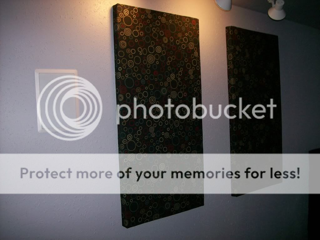

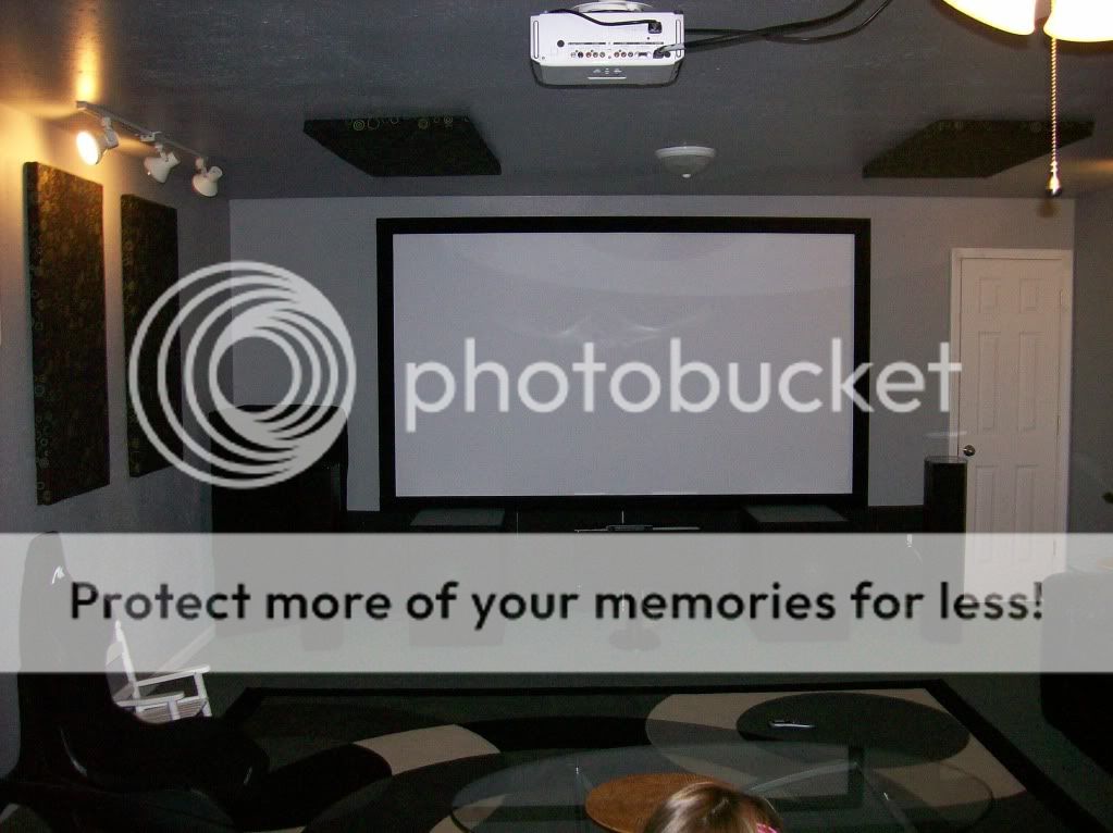

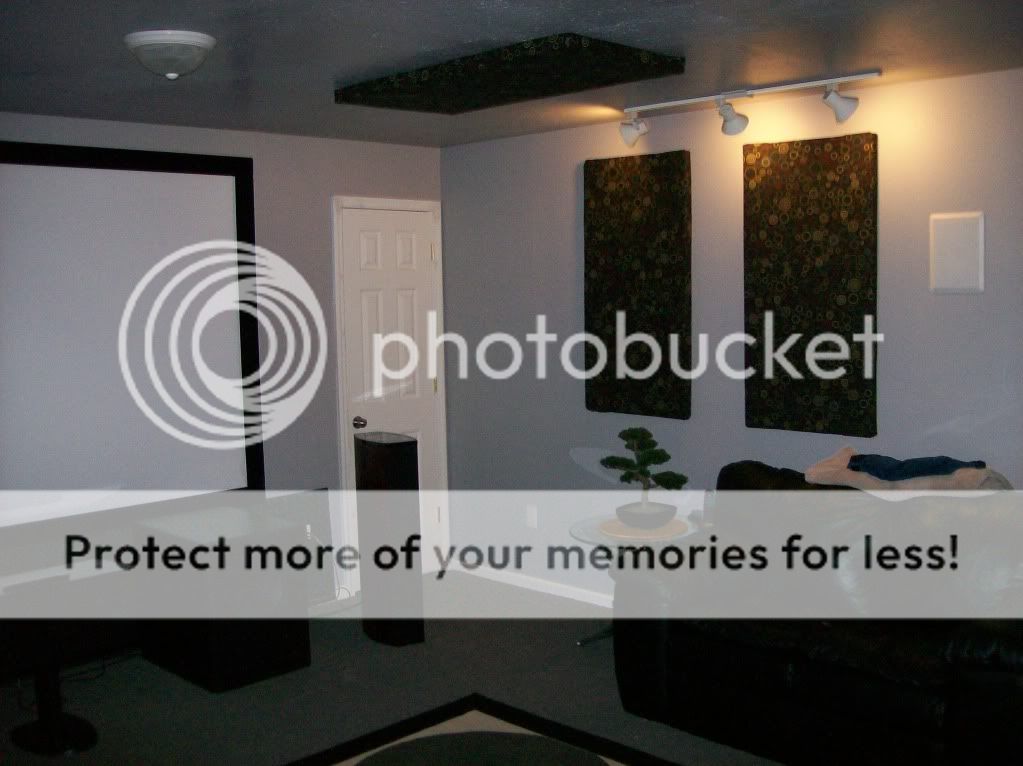

Here's a few pics of some panels I bought and put together myself. Very easy to do, and A HUGE upgrade in sound in my room. Bought all the materials including hanging materials from ATS acoustics that I linked in my previous post.
Very nice. Glad you sent pics. Just left the atsacoustics.com and was trying to decide between the 24x24 or the 24x48 size. After seeing your pics I think I will go for the 24x48 panels. I see that you have two panels on each side wall and on the ceiling near the speakers and not on the back wall. Do you have more positioned around the room? Because of the window on one side and a very large wall mirror on the other, I can only put one panel on each wall near the speakers and tv. I could put two more, one on each wall below my surrounds and one panel on each side of the window behind the tv and spkrs. Seems the company recommends the 48" panel for the corners. Do you have any suggestions? Really feel like an idiot and a pain with my questions, but I do appreciate that there are guys like you and the others who have responded. Hope everyone appreciates you all as much as I do.

In the corner is actually a bass trap. Similar to this...
http://www.gikacoustics.com/gik_tri_trap.html
To be honest with you, I would call ATS acoustics and let them know you'd like some options to treat your room. They may want a few pictures and will definitely want dimensions.
I'd also call Gik acoustics, the link in the top of this post and ask the same type of questions.

Here's a few pics of some panels I bought and put together myself. Very easy to do, and A HUGE upgrade in sound in my room. Bought all the materials including hanging materials from ATS acoustics that I linked in my previous post. ...
Boy, those are very nice panels and can be well mixed with room decorations.:D
