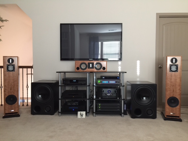

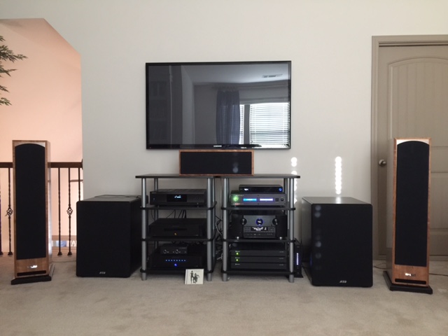

My space is roughly the same size (18'x16'x9') and also open to other spaces. I have two HSU 15" subs...for music the bass is even throughout the space...for movies, when you expect BOOM, you get house shaking BOOM.
If you will have long runs to connect the sub(s)...I like the HSU VTF 15h mk2 because you can use the balanced connection.
For your size space, if you don't have long runs to connect the subs...I'd save some money and get two HSU VTF3 Mk5...you will be impressed. I have this model, and they cruise along barely breaking a sweat until called into action.

I don't know how you're going to use your system, but it's very likely these two subs would not be breaking much of a sweat in your space either. But...if the money doesn't matter and you want the larger subs...it's not a mistake, nothing wrong with OVER subbing.
