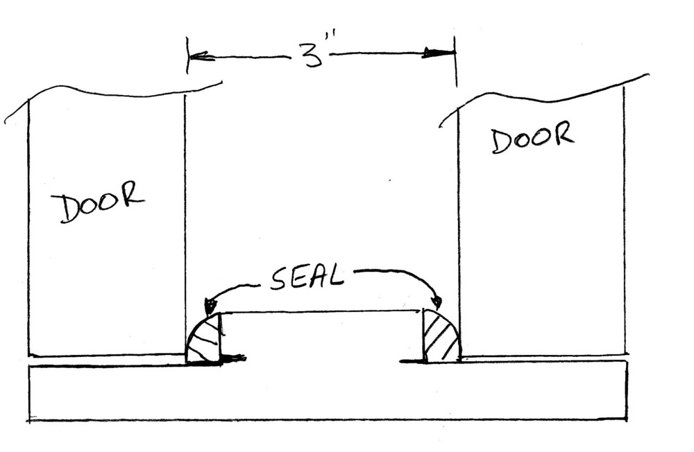

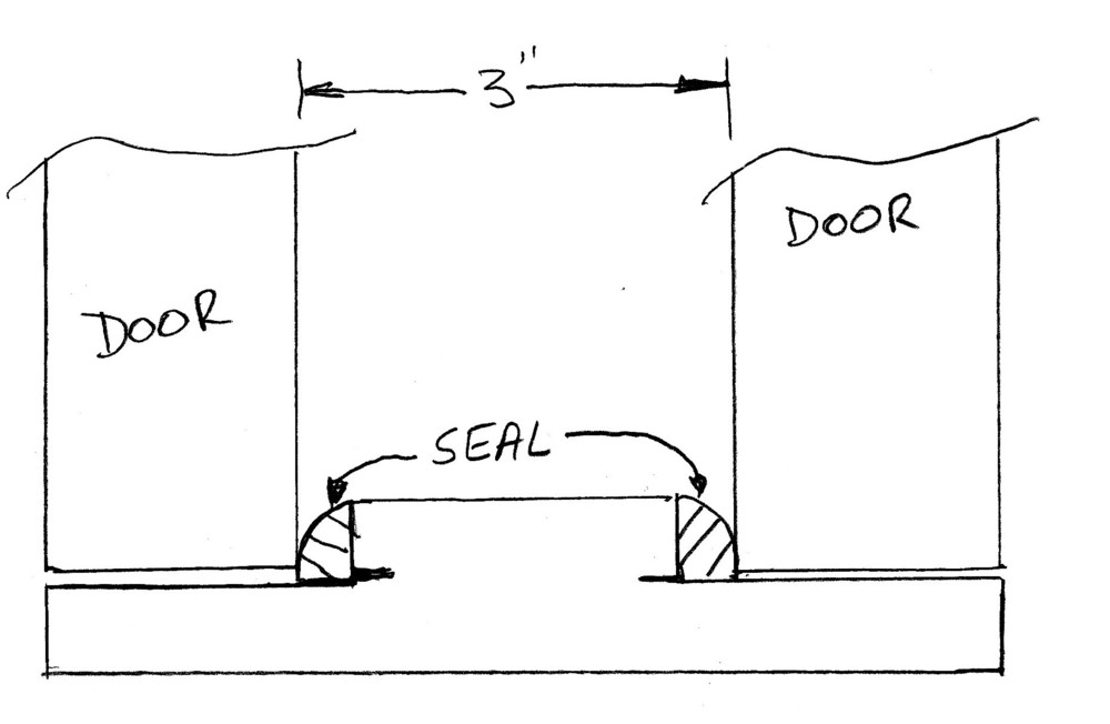

Draw up some cross section to see how wide you'd need. My rough sketch is a 6 1/2" jamb with 3" between doors but that depends on the handle depth.

Draw up some cross section to see how wide you'd need. My rough sketch is a 6 1/2" jamb with 3" between doors but that depends on the handle depth.View attachment 22465
