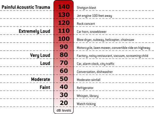

By the way, 34 dB on top of traffic can be pretty loud- probably louder than you would want for any Therapy. Faint traffic would be about 60 dB C-weighted. Near traffic would probably be 70 to 75 dB. Even at 60 dB, 60 + 34 = 94 dB. 94 dB is quite loud to listen to anything continuously. You don't make it sound as if you will be doing some head-banging either.
