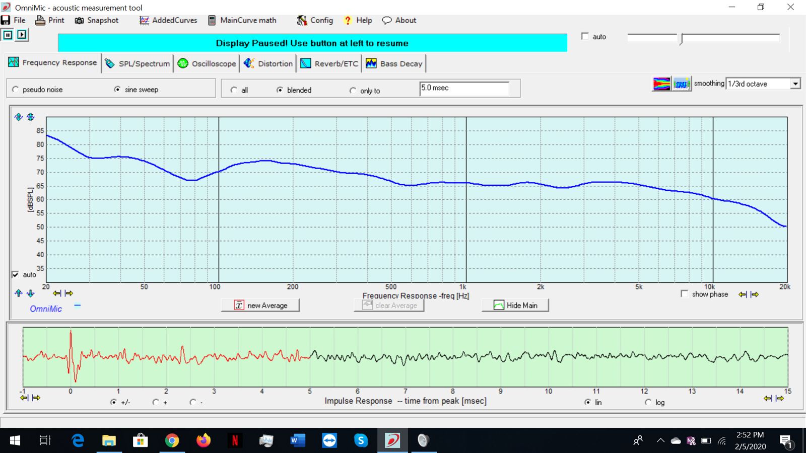

As evidenced from your shared graphs (see below), your own system has a 20dB drop from 20hz to 10khz (10dB from 100hz to 10khz)? So you need to elaborate on how that follows your idea of a straight line.
I'm very aware that I may be misunderstanding either what you mean by flat/straight and/or what this graph visualizes (actually I'm pretty confident it's one or the other). So I'm not saying you're contradicting yourself or that you are wrong, I'm asking for more information to understand your standpoint. :) When I understand that, I will be happy to share my own views on this interesting subject as well. :)
(@TLS Guy in-room graph as shared in the other thread, if I understand his references correctly)

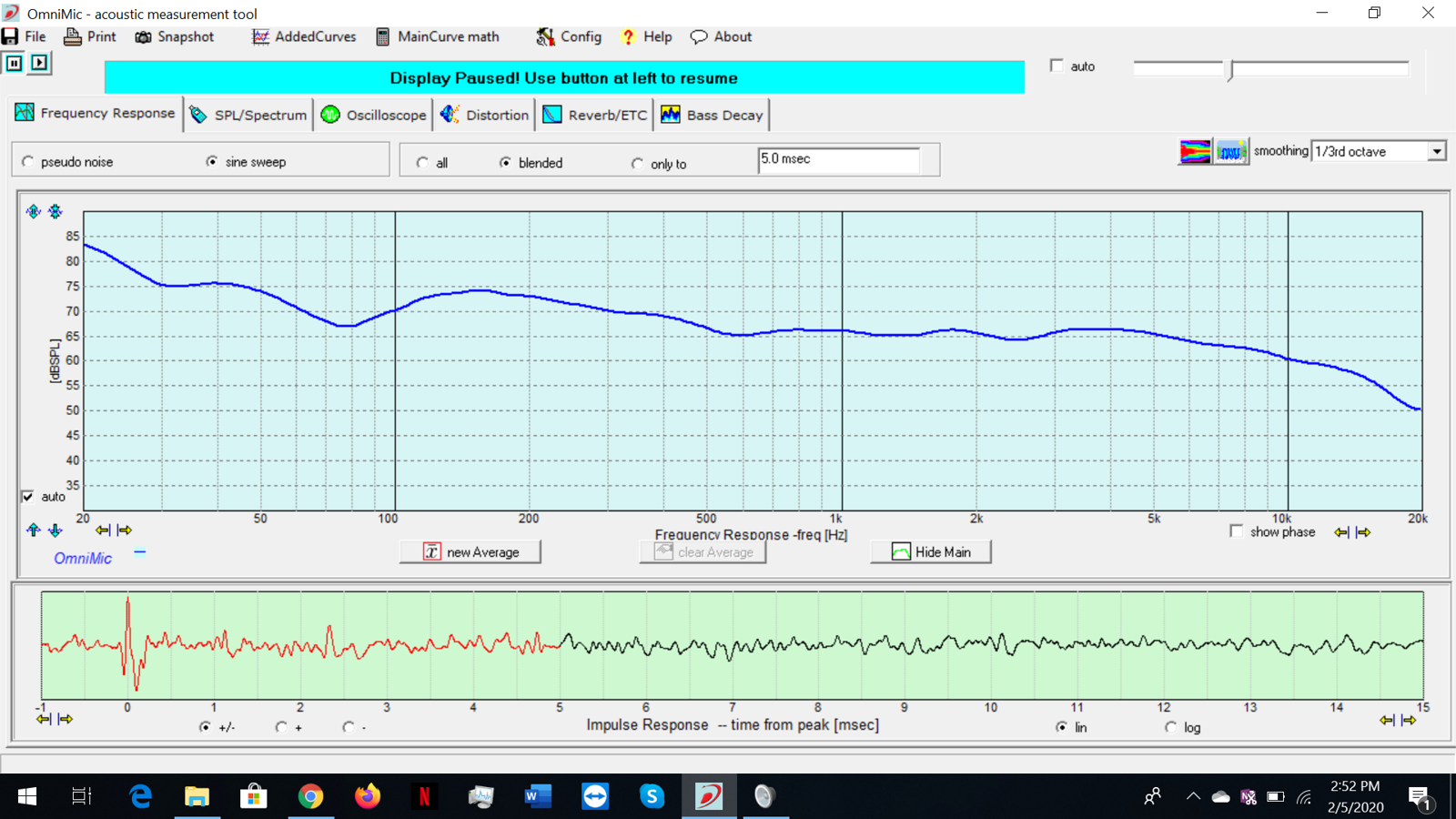

Well, that is a good question. However, that curve is taken at the MLP. So, the HF will taper at a distance which at the MLP in that room is about 16 ft.
Now the ear expects that. It will be the same taper for someone speaking in the room or playing an instrument. As I said, the ear expects that. Where you need the straight line is on axis of the tweeter at a distance of one to two meters. I use 2 meters as a rule. Then you have to let the room do the rest. It is my observation that you can not "force" the room by what your notion of what the room should do. I think somehow our brains are wired to know what the environment will do.
Even so, with speakers there is a fall off of HF as you move off axis, which will be dependent on tweeter design more than anything else. However as you move off axis the response must closely mirror the axis response except the off axis taper with increasing frequency. If not the our brains really cry foul.
So lets us look at the responses, the first on axis 2 meters distant from the tweeter. The taper above 15K is due to Omnimic, that is a well documented problem.
Now lets see one more time what the room does with it. There is room gain, AND the expected taper in the HF due to the room attenuation of the reflected portion of the HF spectrum. All rooms do this to a varying degree, and the ear expects this. If you try and modify it significantly the ear cries foul as it does not expect there not to be this room attenuation. I should state, there is no room Eq, using Audyssey, or anything like that.
That is exactly what you would expect a room to do at 12 to 16 ft. distances from the speaker. If you try an correct this, then it does not sound right at all.
The last two octaves are a different case though. Here we have room gain, and room long wave reflections with the potential for peaks and nulls. These are determined to a very large extent by the ratios of the room dimensions. If you have the luxury of designing and building your room, then you have the ability to optimize the room dimension ratios. This is an area where determining the best response here does benefit from room optimization, and critical listening here, without preconceived notions, achieves the best results. This is where your active design will give your customers a degree of optimization not generally available now.
These auto calibration programs, impose preconceived notions on the room, which likely have more chances of being suboptimal than not.
What, I and others have noted that from 1KHz to 10 KHz at 1 to 2 meters, the axis response needs to be as ruler straight as humanly possible, with the off axis responses falling off in a smooth fashion increasing their slope with frequency. That is the best a tweeters can currently offer.
The problem area is that range from 80 to I Khz or so, particularly from 80 to 500 Hz. This latter includes the Baffle Step compensation range of most speakers, and is a range where the involved drivers have to receive large amounts of power. This is where good motor design sorts the "wheat from the Chaff". It is a crucial band however. I pointed out previously that it contains the fundamental frequencies of a large number of instruments, especially the foundational instruments. This is not an area where you want to be lacking in power, or dip the response.
This is an area though, where room and speaker position do come into play. Here your active designs will have a huge advantage. I have found with my active feeds, with variable BSC, that the amount required is in fact highly room, and also speaker position in the room dependent.
So this does leave me with one piece of advice for you, to make the BSC variable, and also preferably have some way to allow the consumer to set it with instrumentation. Many members here already have that facility.

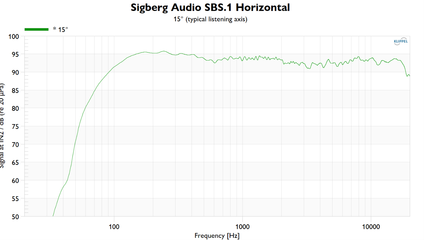

@TLS Guy Then we are largely in agreement. It was confusing that you were referring to straight lines when we (or at least I) were explicitly discussing and referring solely to in-room measurements at the listening position in the other thread.
I also agree that the 80-500hz area is cruicial, which is why we have dedicated drivers for this range (more precisely 90-600hz) in both SBS.1 and the upcoming Manta. And both speakers have, not dips, but a slight lift / tilt in this area, as evidenced by the anechoic response of the SBS speaker:
BSC is quite effectively adressed in the SBS speakers by its 2.5-way design (dual drivers in the 90-600hz range), and in the Manta by having a massive midbass driver that happens to have roughly 6dB higher sensitivity than the coax. Both are of course fine tuned in addition to that. If the consumer needs to alter this due to room issues, there are as mentioned in the other thread both boost/cut and shelf filters available individually in each speakers, so in practice the BSC can be adjusted. The final octaves (~20-100hz) are also easily adjustable by either EQ and/or adjusting the volume of the subwoofer.

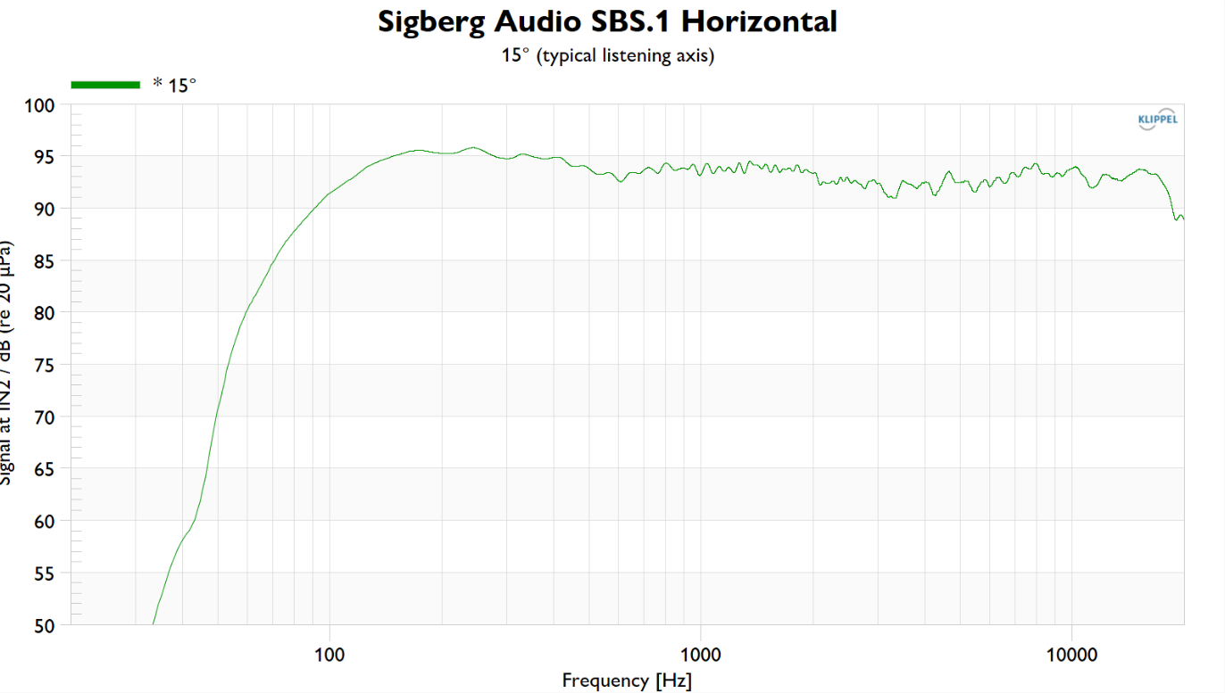

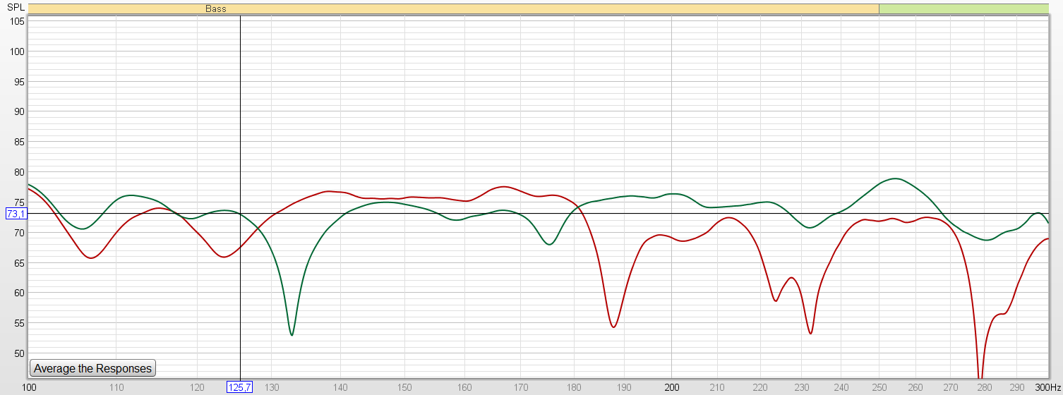

Here's the left and right speaker from the listening position. They're both at equal distance from the wall. The red graph (left) where we see most problems are located close to a corner. The green graph (right) is free standing (no walls directly on either side), and as you can see (this is still zero smothing) has minimal issues, and the 180hz dip is not present.
It's impossible to perfectly eliminate these types of boundary effects. What I can do (and will do) is measure this speaker anechoically (as we already did with the previous prototype), and control whether the cardioid effect in this frequency range is even. If it is, that's the best we can do with this approach. I expect that it will be. The main difference between this prototype and the previous is changes made to make the cardioid effect work even better in the lowest octaves (~50-200hz).

They are designed to be placed 10-20cm from the wall. Any closer than ~10cm is practically difficult due to power and XLR cables and being able to access the amplifier.
The cables are inserted horizontally and not vertically?
Deviations in response between 100-300hz is indeed often due to the wall behind the speakers or some kind of boundary, so that's a reasonable assumption. But as I've said repeatedly, the referenced measurements from the other thread were stereo in-room measurements done from the listening position, they really can't be used to figure out much without knowing anything about the room, the listening position or the speaker positions.

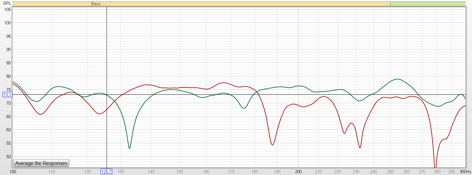

Not yet. Another way of evaluating the phase coherence of the speaker is to measure frequency response and phase anechoically, which we of course also do. Both SBS and Manta maintains linear phase through the crossovers between both midbass/midrange and midrange/tweeter.
Yes, those are the breaks. It is disappointing that the results are not better close to the wall. That red curve is pretty lumpy. It seems the bass driver is responsible. It is a pity the cardioid designing was not more effective in limiting this problem. The green trace is really very good and I doubt that narrow Q dip just above 130 Hz is audible. However I suspect that red trace is not optimal acoustically. So essentially these speakers actually need conventional placement. Adsorbing material behind the speaker might help.
This technique I used of the swept front baffle, is effective at dispersing these troublesome reflections.
I am indebted to the late John Wright of TDL who used this technique in his later designs. I also used his design of dual TLs tuned half an octave apart. He used this technique in his last design, shortly before his death. Few of those speakers were ever made, and their cost was in the stratosphere. I never turn any good idea down.
You have the advantage of digital crossovers and so can make a truly phase coherent speaker. In the above design the two 7" drivers are allowed to roll off acoustically, as they are robust drivers. The BSC is sent to the upper 10" driver and the SUB LFE signal sent to both 10" drivers. It is unusual, and many would say "oddball". They are however very effective speakers. Three Quad 909 power amps drive that pair of speakers.
