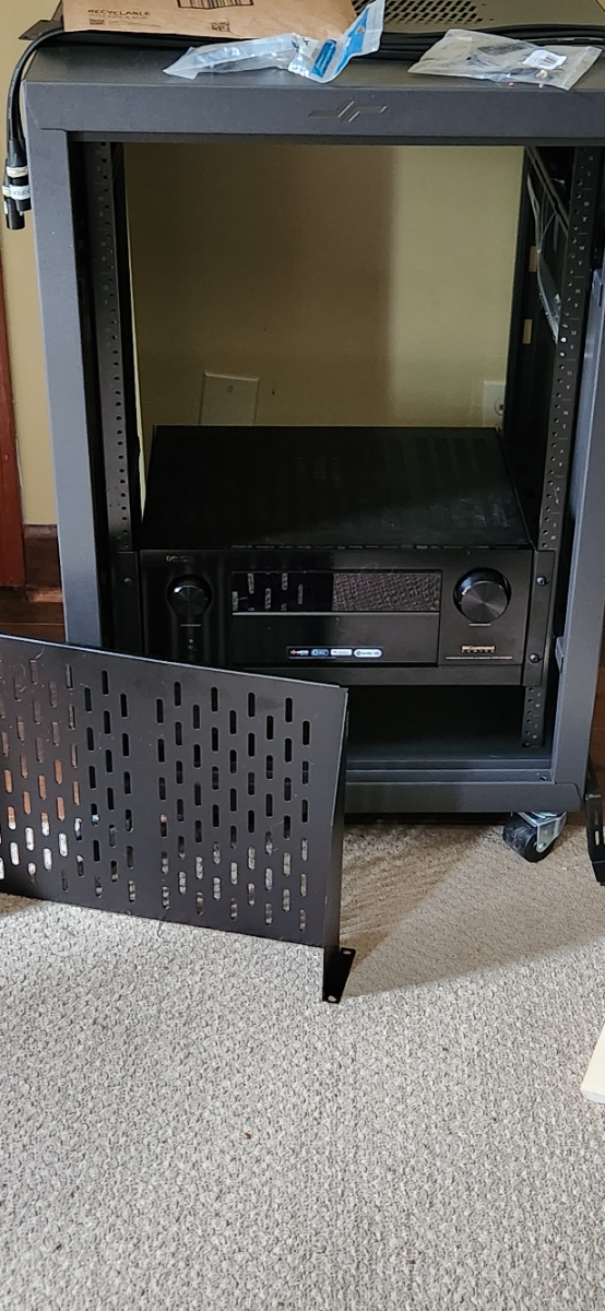

I've made so much progress :rolleyes:. Well, not really a biggie as the rack accessories have been trickling in, with the last of them arriving tomorrow. Have zero complaints so far and can't wait to get some measuments.
