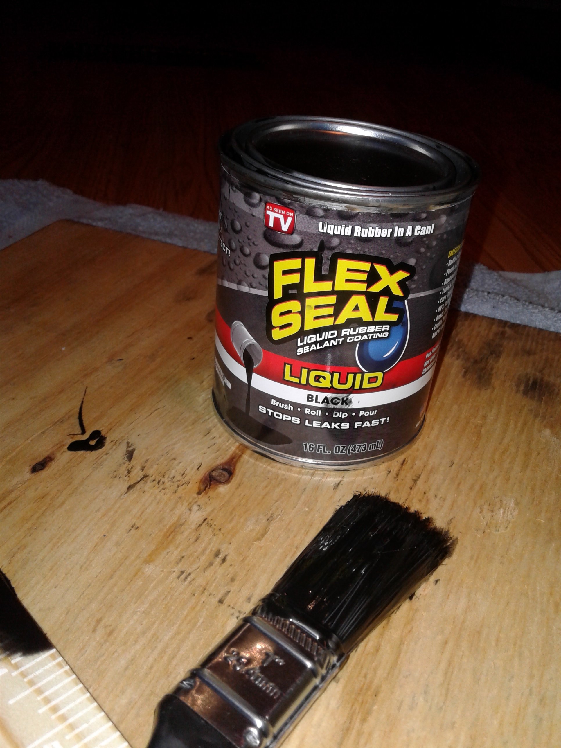

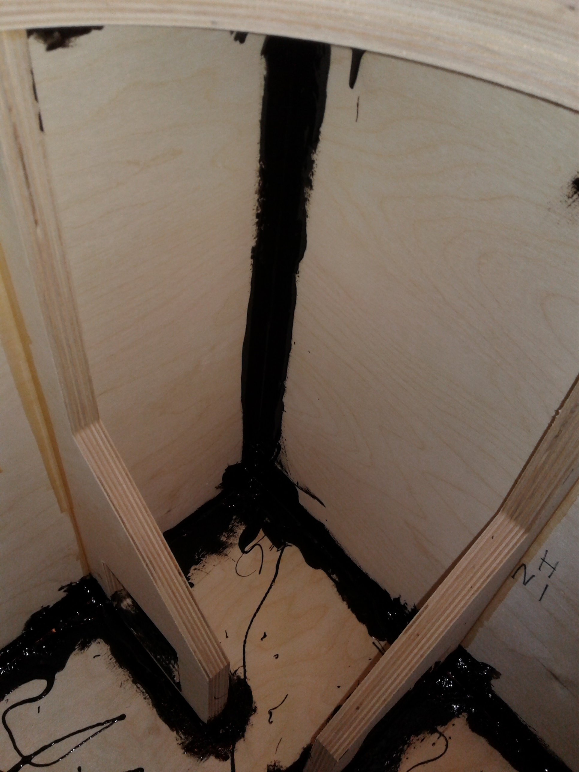

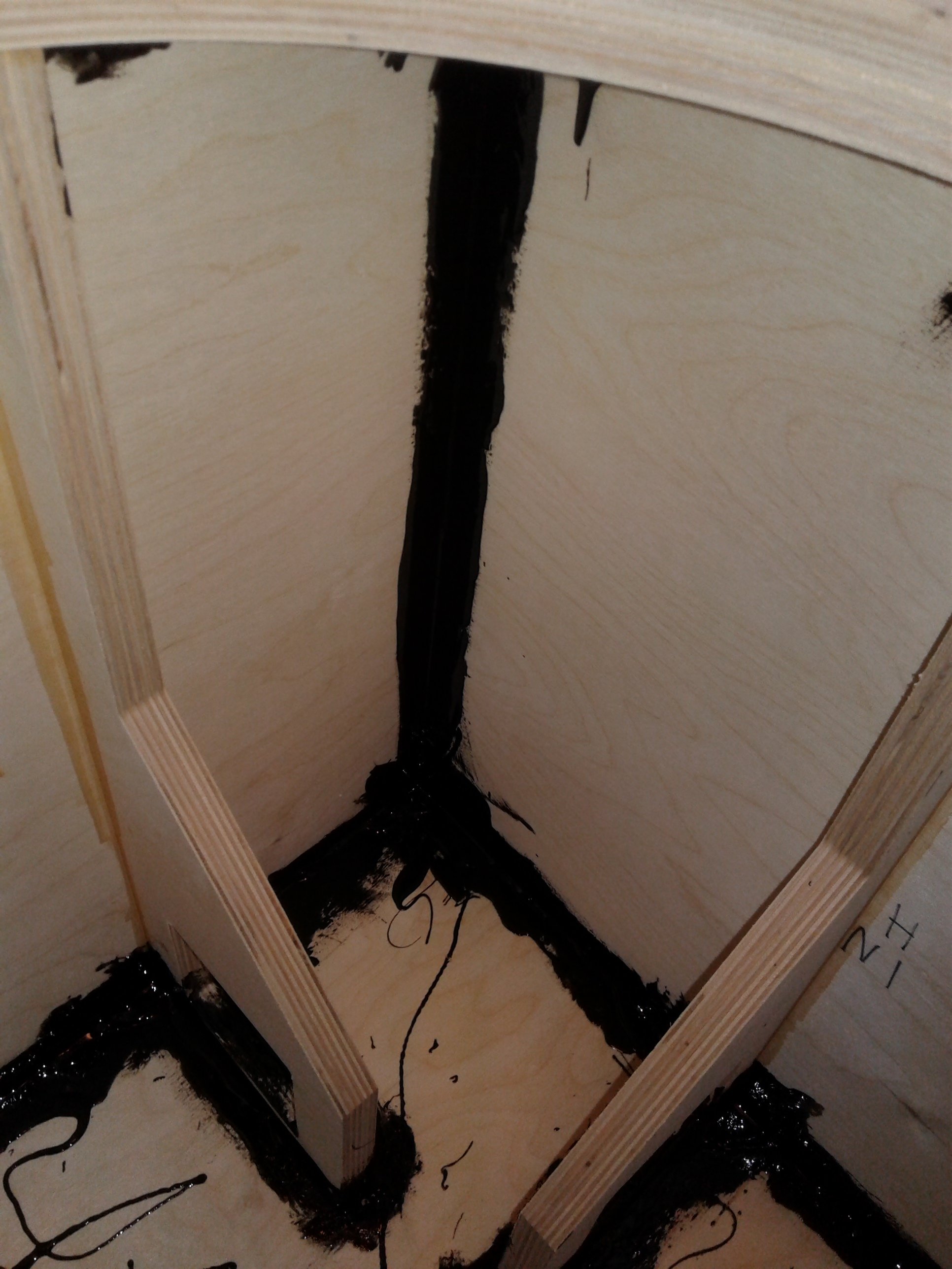

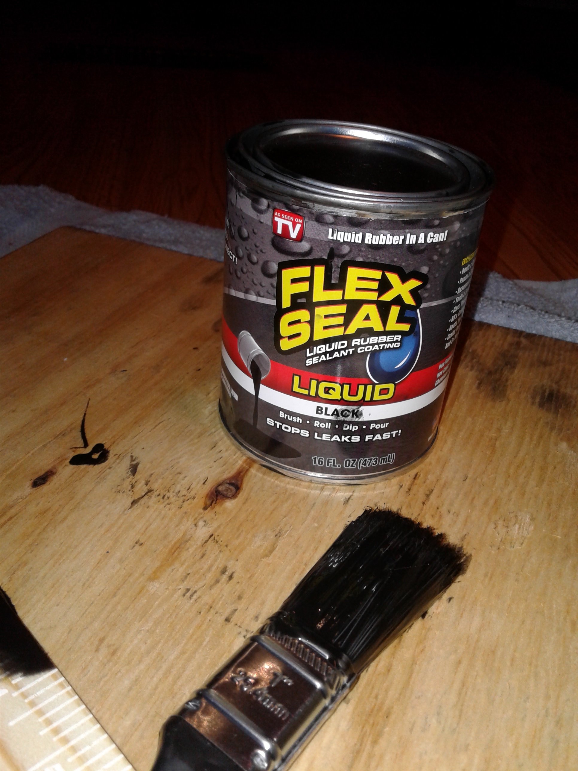

Anyway I went with the Flex Seal in a can. Yeah its messy but I think it gives better coverage.
Wood glue might provide a good enough seal, but wood glue is not intended to be used as a sealant since it shrinks as it dries.
As long as it remains flexible and seals, its getting the job done. No one else will see the inside of the cabinet :).
Those are big cabinets. Subwoofer?

Holy glue-up, Batman! I have never seen building a box over-though to this extent.
Use wood glue for the joints. A flexible sealant will cause the joints to fail under extreme stress. If the goal is to make a durable, inert cabinet, use some kind of mechanical fastener along the joint, too. If the glue doesn't fill the gaps, THEN, use a sealant. Any sealant. If you use silicone, wait until it no longer smells like vinegar before installing the drivers- problem solved. Otherwise, use latex caulk but DO NOT use it to attach the joints- it WILL fail.
In the 20+ years I spend working with car audio, I saw only a couple of box joint failures and they were all caused by the customer ignoring the advice that they not crank the system until the next day, at the earliest. One guy drove off and before he even got to the street, we could hear that his system was cranked and, as we told him, the joints failed. Wood glue and pallet staples work really well for this, but not before the glue dries. I have built boxes of particle board, which is the 'hot dog' of lumber products and when I dropped one of them on a concrete floor, it just bounced.
View attachment 22776 View attachment 22777
With the cnc/dado cut flatpack you're using, a good gluing up should be quite sufficient. Maybe if you had some sloppy cuts and gaps of your own to deal with...maybe sealant might be needed....or just more glue along the seams afterwards.
