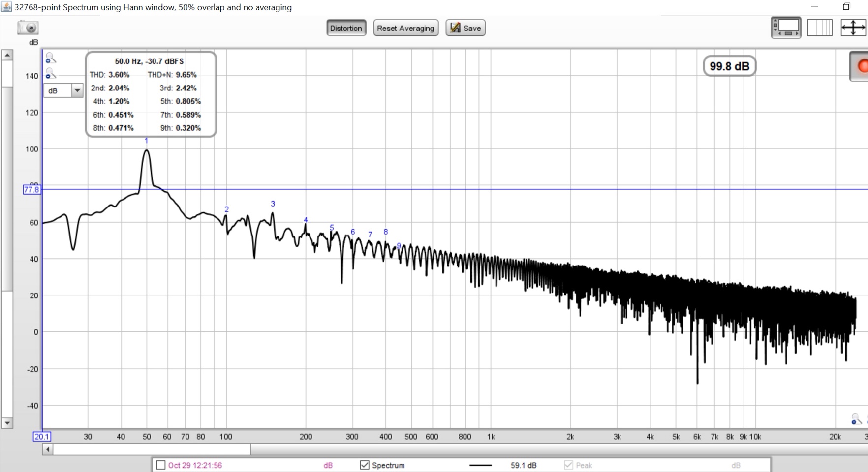

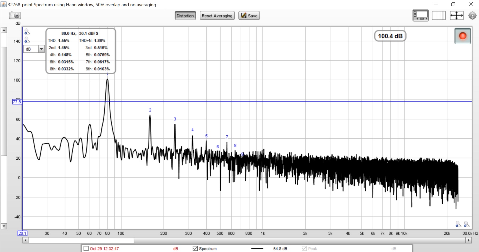

Better off going for an open box RP-150m. Don’t get me wrong, I think the R-15m is a great speaker, but the ceramic anodized aluminum cone in the premiere handles high spl and excursion better at midbass frequencies than the less rigid IMG woofer.
100dB @50hz @~3.6% THD and 100dB @80 hz and 1.5% THD is fairly impressive for a 5.25” driver. Those measurements were taken 3m away.
I don’t have the graph on my phone, but even though both the RP 150m and R-15m have a -3dB response at 47hz & 50hz, the THD at 50hz and 80hz for the R-15m at 95dB approaches 13% and 7%, respectively.
Both speakers measure +-2dB quasi anechoically, and both display well controlled directivity off axis.
You can generally find the RP 150m on eBay for under $300 https://m.ebay.com/itm/Klipsch-RP-150M-Premiere-Bookshelf-Speakers-Ebony-OPEN-BOX-PERFECT-PAIR/202108063656?epid=1537742941&hash=item2f0e944fa8:g:mEcAAOSwB-1Yogce
