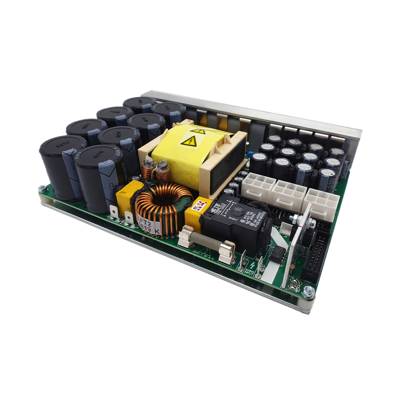

Max output power is listed as 3600w.
This Power Supply can run on 230 or 115v input.
IDK what any of this means, lol.
3600/115 = 31.3, so I need a 30A?
I also don't listen anywhere near reference level (maybe occasionally), so maybe none of this makes a difference.

The Amp in question is a 3-channel Amp using the SMPS3KA400 Power Supply to operate the Newer Purifi ET7040SA Amp Modules.
Here is the Purifi Spec Sheet:
I linked to the SMPS page at Hypex' site above.
I posted that info due to the specific question of what is the output power...

Reading the specs carefully the continuous power output is actually 950 watts. So that 3,600 is a back of the neck spurious peak. The efficiency is 94%. So that means it is a 1060 watt power supply, rounding off the numbers. That means its max current draw is 8.5 amps. So a 15 amp supply is more than adequate. So that would be a worst case scenario supply of 320 watts of power into a two ohm loads with all three channels driven.
I'm confused by this. The Power Supply in question is clearly stated by manufacturer to have 3600w max output. Now how that is utilized through the Amp modules to actual Power drawn by the system, I certainly have made no claims to know.
As always, I hope that you can help me understand it so I can learn something useful in this!
Thank you!
Thank you!
Download the full specification sheet. Look at pages 3 and 4. Even then the specs I worked from are the short term power ratings and how short term is not specified. Even then there is a disclaimer that thermal protection may operate.
One thing I'm certain of that is not a 3,600 watt amp! None of the numbers compute that way.
I was citing the Power Supply alone, not the Amp Modules or the whole system. Of note I can only expect that 3 Amp Modules are being utilized to the 1 SMPS. VTV doesn't give any internal photos or other details about their product.
If you work it back form the output power ratings, and even those are sort term and factor in the 94% efficiency then you have the right numbers.
