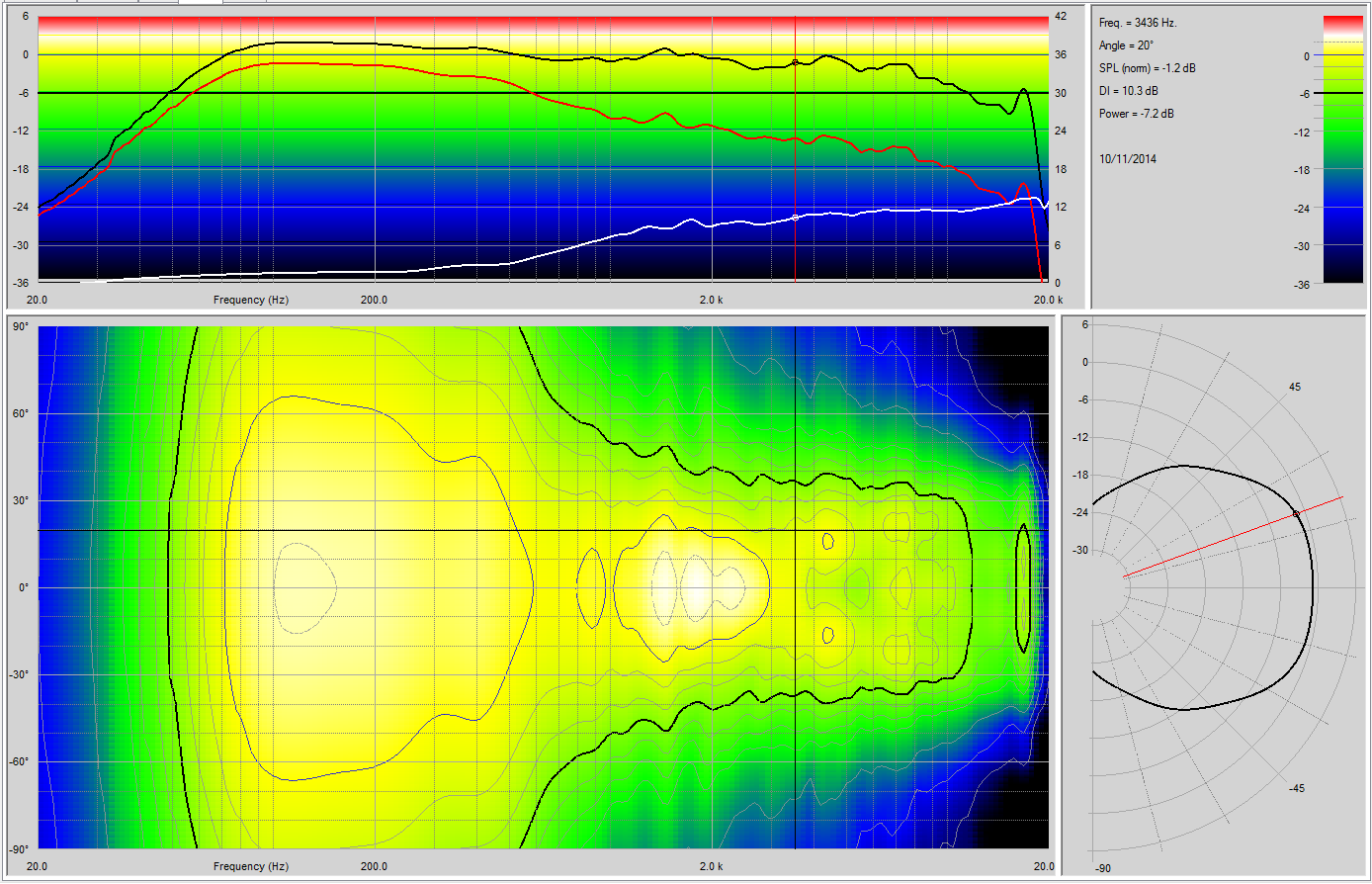

The Abbeys, are large 2-way speakers with what looks like a PA type 12" woofer and a 1" (?) compression tweeter mounted in a round waveguide that looks the same diameter as the woofer. The web site shows these two frequency response graphs, one is the usual type (albeit stretched out horizontally), and the other is the Geddes-type multi-color plot.
The crossover is apparently between 600 and 700 Hz. The upper graph looks reasonable – nothing unusual stands out that might contribute to "that horn sound". The Geddes-type graph shows a prominent ridge between 400 and 500 Hz where the sound dispersal becomes noticeably less dispersed, but that would be below the crossover frequency. So I am not sure I see anything that might be a problem.
I once read that horn mounted tweeters can generate a resonance whose frequency is related to the perimeter of the horn, but I can't remember anything else about that. Does this idea ring a bell with anyone? Is this at all related to "that horn sound"?

I would guess, if a waveguide rim rang like a bell, that should occur at a frequency where the tweeter was making some sound :confused:. In the Abbeys, that's below the crossover frequency.
I know I heard something unpleasant, but I can't explain it. Maybe my guessing is wrong.
