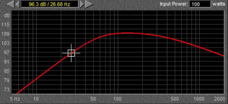

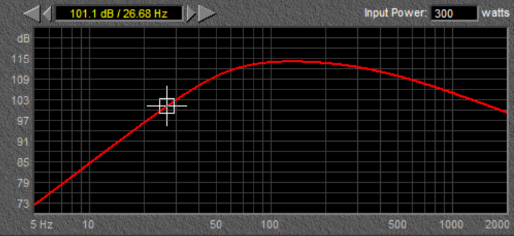

Are you able to show me a power graph? Like, I'm not ordering drivers tonight or nothing. If anything I'm going to try to forget we had this conversation and go enjoy what I spent the last two days monkeying with. The only thing really stopping me from either of those builds is money. I'd like to do them both. I'd like to build 2 of TLS' alignments: one with a tube port and one with a slot port. But I'm a lot like Doug. After doing a bunch of talking I'm just not going to do sh!t other than drink beer and fart. :)
The advantage over Mark's alignment being the boostable 12db/octave roll off. I see it now. I gotta find that thread and see what spl Mark was projecting with 250 watts. Going from memory, you guys have close to the same F3. I can't remember the output though. I understand and appreciate the extension of sealed. But if I skip the dsp and extension I'm still skirting the more troublesome low frequencies that gets you the evil eye from the neighbors. That's all just talk. The best solution so far is the one in place. It's paid for, it's built, it's in place, it works, no noise complaints so far.
Something like this? If you click on it it should bring you to photobucket where it's a little bigger

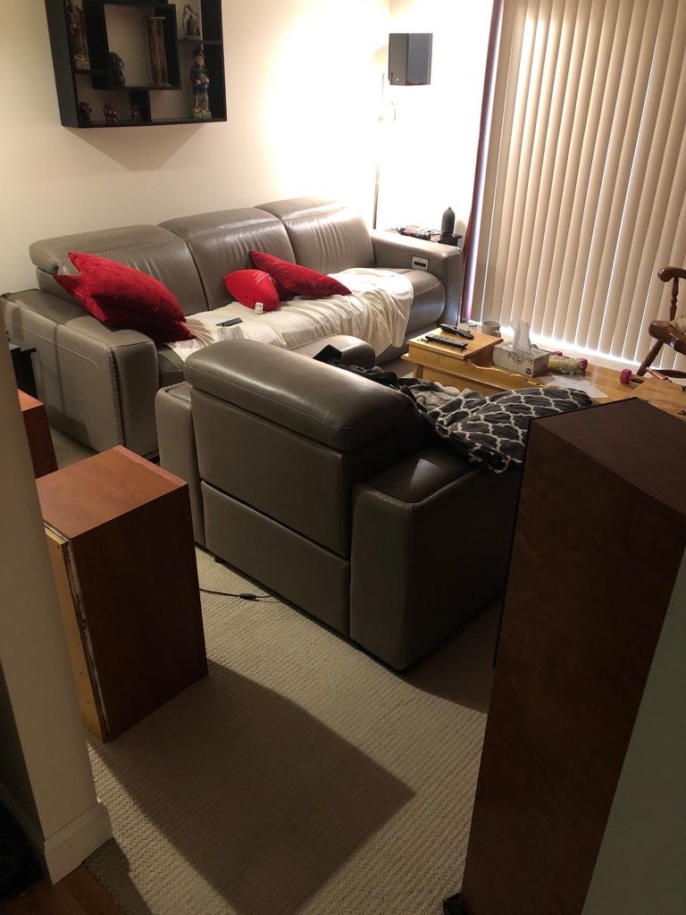

I'm all done moving stuff. Hate sayin' it but I jammed a record player into the entertainment center. The worst placement option in the history of vinyl but nobody said it was going to be easy.
The idea was to take pics with my phone but after 1 pic it told me to f off. So ... the point was to take a couple of before ... you know, my camera and imgur ... nah.
Anyway, after I moved my first diy subs along, I missed the bass. So I decided to pull my 2nd diy sub out of ManTown and use it in the living room.
crap, I've got the stock for the Cherry molding on the back. I could be sizing the cuts ... I've got wiring stuff to do too. I'm using the same Rotel from Mantown on that dual driver diy deal there. It's gonna live in the entertainment center. Each driver gets it's own channel on 11ga wire (2 14ga conductors).
And I am gonna move those surrounds. It's making me nuts having them stuffed in the corner. My old surrounds were on wall mounted arms as opposed to being directly wall mounted.
