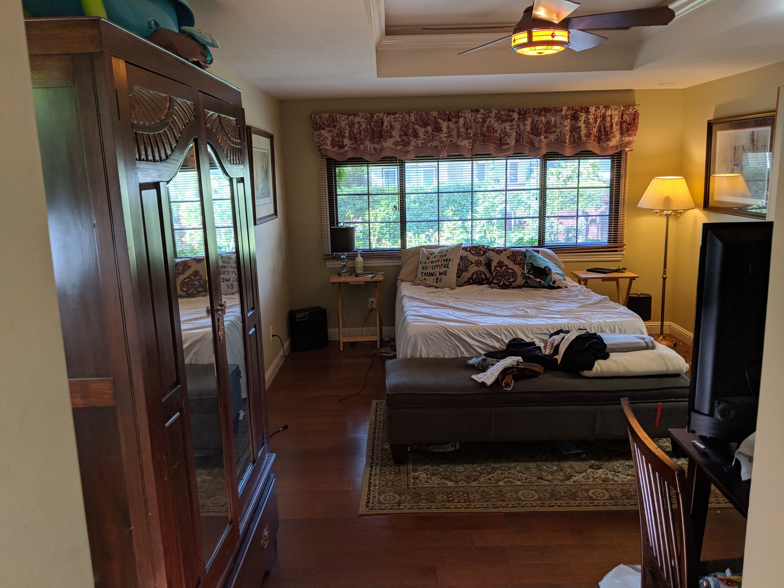

The room is just about 1400ft³- 15¾Dx11¾Wx7.5H. I included a pic of the ceiling, which makes me wonder about possible challenges with wave patterns.
The bed will be replaced with a sleeper sofa, placed 2ft off the back wall, and the LCR will be 1ft to 2ft off the front wall, so anywhere from 10ft to 12ft for the listening position. I'm thinking front left corner as there's the backside of my chimney and I feel like the brick might benefit that sub. Eventually I'll add a second sub (along with the surrounds)- I guess I'm shooting for 5.2:). I've thought about the Ultra surrounds to allow me to go straight to 7.2.

I would choose Rythmik L12R everyday over the SVS PB1000. I have the LVX12 in 2600 cubic feet and it is more than I need. But overkill is a good thing. Also you might want to look at HSU VTF2 but speak with a member that has one. Good luck!
@NorCalRP I'd say your room is a bit small for a 7ch setup. I'd also consider the Denon 3300 for the better XT32/SubEQ for two sub setup. Also for inclusion of pre-outs, for future considerations at least (to give you amplification choices).
