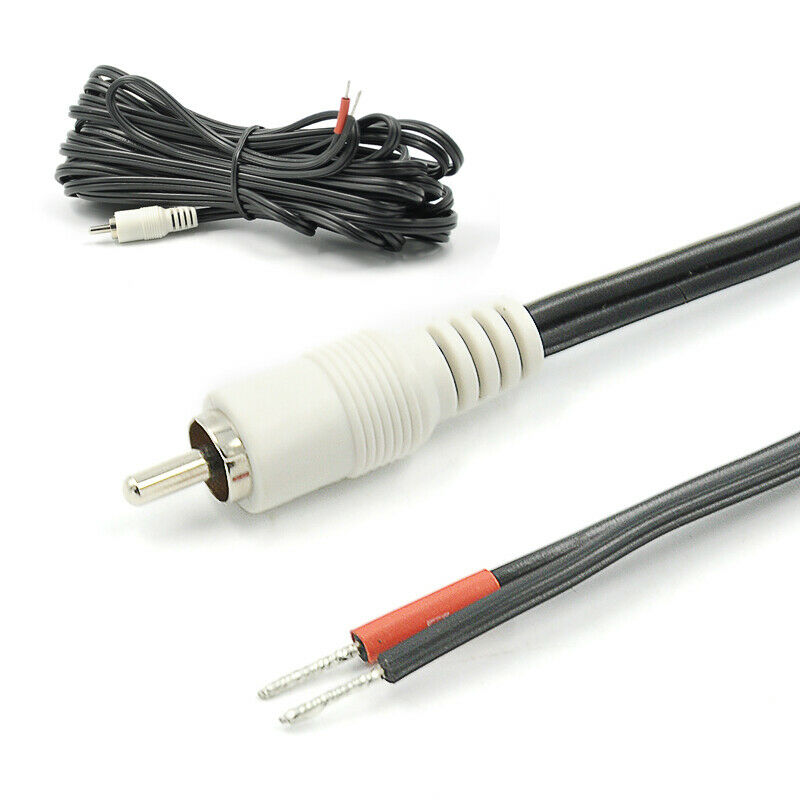

can't imagine the wiring is longer than 25' to get there). Diameter of the wire is about 1/8" per wire (when attached together they're a hair under 1/4" wide).
Can you post a picture of what that wire looks like ... Also if you can go larger than the Cambridge Minx speakers that I posted, then that would be better ... Speakers at least the size of RSL would be a better size

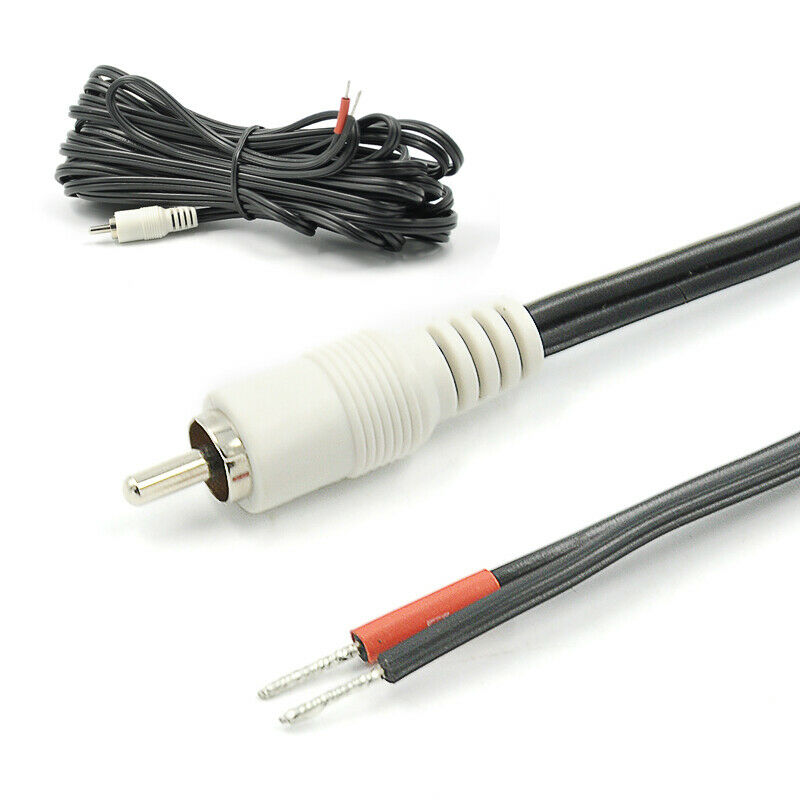

Is this what your 38 system is using?
Yes that photo is right. And yeah leaning toward the Minx speakers as they seem right-sized and an improvement over what I've got currently. Assuming I can use the Bose wiring, I would replace the 5 Bose speakers with Minx Min 22's and see what I can find perhaps at Costco for an AVR, and probably go with the Speedwoofer as mentioned above. How confident should I be that the wiring will work for me? Thanks much everyone for the guidance.
I can not say for sure, but you may, that is you may be able to modify the RCA end by cutting it off and see if you can use it as the other end of the speaker cable since it looks like two wires going into the RCA connector ... maybe there will be some more advice on this ... yes Costco is a good place to check for a receiver
Yes, if you cut off the RCA plug on the one end you should be able to split the wires so that both ends are the same. The only thing we can't really tell from the photo is what gauge wire the cables use. If it's 16 gauge or heavier you should be ok. If it's only 18 gauge (higher number, smaller diameter) it may be a little too thin but that will depend on the receiver and speakers that you get. If you're only looking at 50W or 70W per channel and not planning to play at high volumes, you can get away with lighter cable, but if you get a 100W per channel receiver and like movie theatre level volume, then you would want to replace the wiring with at least 14 gauge (available on Amazon and Monoprice). Longer cable runs will also require heavier gauge cable. The cables you have will work; they just may not be ideal.
I believe that the Bose wire is 16 awg
