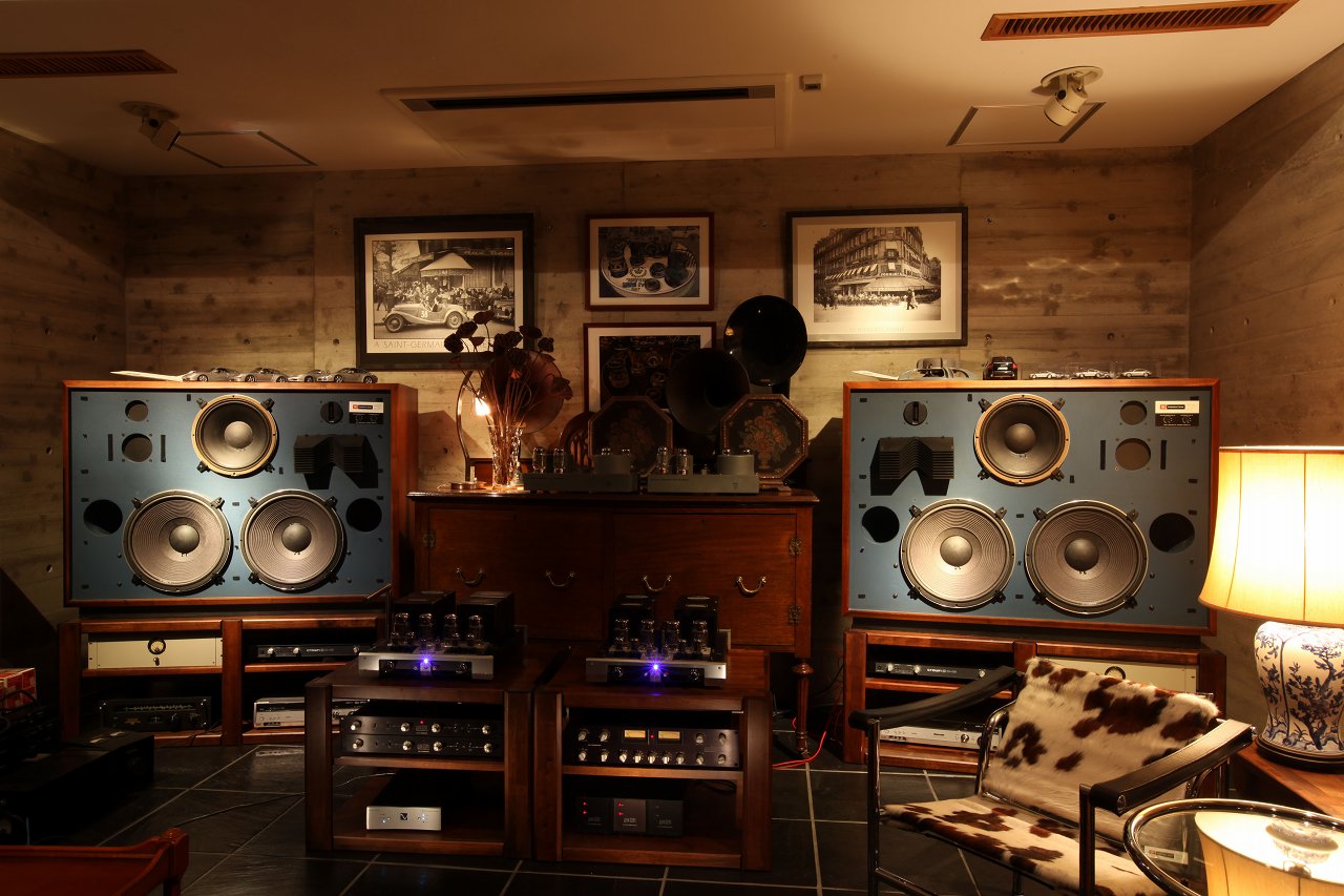

I just recently lucked into a pair of very nice 60s era JBLs. They look exactly like the Olympus series, but these are custom made with slightly different cabinets. They are huge and they are absolute tanks. All of the drivers work well.
They look exactly like these but with slightly different cabinets. The drivers are all identical as is the hardware on the backs.
So, my dilemma is that I don't know what to drive these things with. Any advice would be appreciated. My budget is limited, but I could save for the amp.
I am currently using a Marantz 2275 and it's a tad shrill at times.
Thoughts? Ideas?

The problem is those Olympus speakers had a fundamental problem. The bass section has one active driver and one passive radiator which is why they look different. Depending on iteration the bullet tweeter is different and possibly the crossover. The fundamental problem is that the woofer crosses over to the horn at 500 Hz. That horn is much too small for that and does not have a mouth width to go down that far. Cut off of a horn is determined by the width of the mouth.
In the later 70s iteration, a midrange driver was added, which should have been done in the first place, and the drivers became active with porting.
These were better, but I never rated that series as good. In fairness they started out before Thiel/Small and before CAD crossovers. So pretty much all speakers were designed by instinct and ear. There was very little science to it. It was Raymond Cooke at KEF that first started to change that. This approach was slow coming to the US and designs significantly lagged UK designs for a long time.

I think you have heard more modern speakers now. A vintage tube amp that roll off the high end might help a bit, but you could do it cheaper with an equalizer and it would probably be a better solution.
A new crossover design, raising the woofer/horn crossover to 1200 Hz or so would likely help. That would be a big undertaking though to really get it right.
You really will not get those speakers to sound like what is available today. They just have so many design features about them, that we now know are dead wrong.

It may be possible to design new crossovers for those speakers, if you're interested. It will require computer based measurement and design software and a measurement rig to test what would work with those speakers.
Try posting about these speakers on Tech Talk Forum, where many DIY speaker designers hang out.
Depending on where you live, you may find some one nearby who is interested. Those speakers look large and heavy, so I'd guess a computer and measuring gear might be more portable than one of those speakers.
I have had one other thought. Depending on vintage, those speakers are very likely 16 ohm. So you could be running your Marantz into voltage clipping.
The crossover model number on the back will help you sort this. The 16 and 8 ohm speakers obviously have different crossovers. If this is early sixties, these speakers will be 16 ohm. If that is the case you need a tube amp with a 16 ohm tap on the output transformer. If that is the case I would try and pick up a Dynaco tube amp and pre amp, if you can find one.
