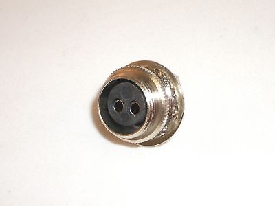

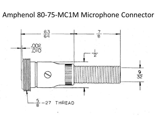

On thinking about this, I suspect they did not use Amphenol speaker connectors but Amphenol mic connectors.
These have not been made for a very long time.
There is some new old stock here.
If that is not the right one, then it must have been a custom production job, and you will never find them, and you will have to move on.

How about this:
