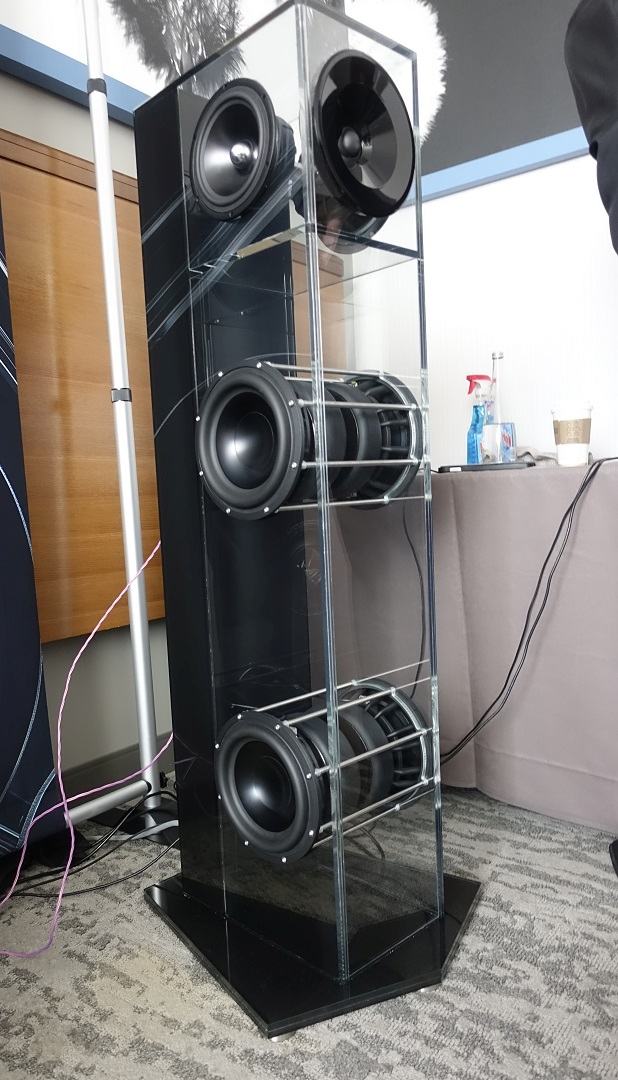

Perfect8 has an unusual MTM arrangement--the mids are mounted behind the tweeter on the sides of the cabinet, opposed to each other. They claim this is to eliminate cabinet resonance and give a cardioid radiation pattern. Would this give the same kind of comb filtering issues as a regular horizontal MTM or would the opposed drivers create a sort of a virtual centerpoint behind the tweeter?

They're not MTM speakers (D Appolito) and I can't imagine directivity being all that good with no forward facing woofer below the crossover and being passive I'm not sure how much cardioid effect it will display. Id like to see measurements of them.

That is an absolutely stupid idea, and will NOT solve the problem of a horizontal MTM. In addition all the midrange will be off axis. For those drivers crossover will need to be no higher than 2.5 KHz. So most of the speech discrimination band, actually just about all of it, will be off axis.
There has never been a shortage of people bringing lunatic speaker designs to market, and this one is high up the lunatic scale.
They are correct that the design has the potential for resonance cancelling, but creates more and worse problems than it solves.
I don't know the volume of the enclosure, but having worked with those SEAS Excel drivers, I have a very strong hunch the enclosure volume is too small, and I would expect a nasty honky response.
I would imagine its speech intelligibility is way below par. One of the most important functions of a center speakers is to provide clear AND natural speech.
I know how to deliver that, but I have grave doubts those designers do.

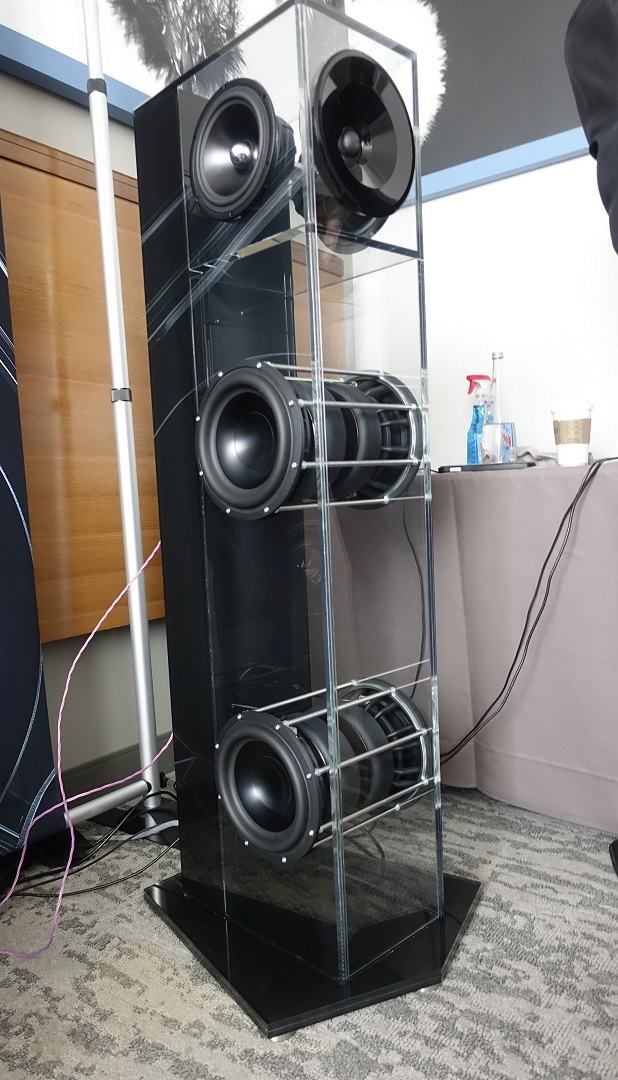

I saw the Perfect8 tower at AXPONA and was considering giving them some coverage if only to point out that problematic design element, but I only have time and space for a handful of exhibits, and I am trying to only pick a couple of fights at a time. But yes, this design should lead to comb-filtering, among other problems. It would not give a cardioid radiation pattern if the drivers are wired in phase and share the same bandwidth. The on-axis response would probably be pretty bad. I will give the speakers this: they had impressive bass, but it's not hard to get a lot of bass in those small hotel rooms. Here is a pic that I took:
