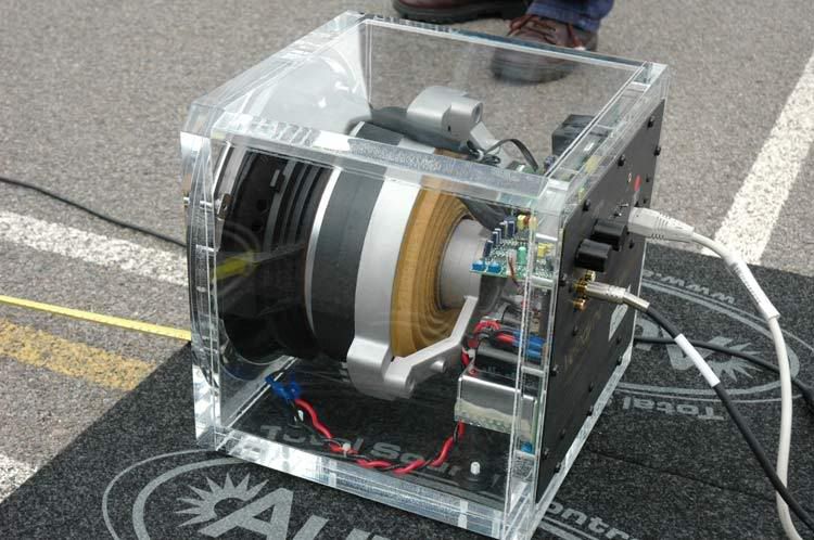

They must be braced well enough or we'd have heard about the problems. Check out the clear DD10 not much space for more bracing

That's a small enclosure. The walls on the DD-18 are much larger, which in tern makes them more prone to resonate.
Here's what Velodyne say
the cabinet has been engineered to eliminate resonance and create stability
Whether you believe they've done their homework or not is your choice, but they're one of the oldest subwoofer company in the world, so they must have learned a thing or two over the years.
