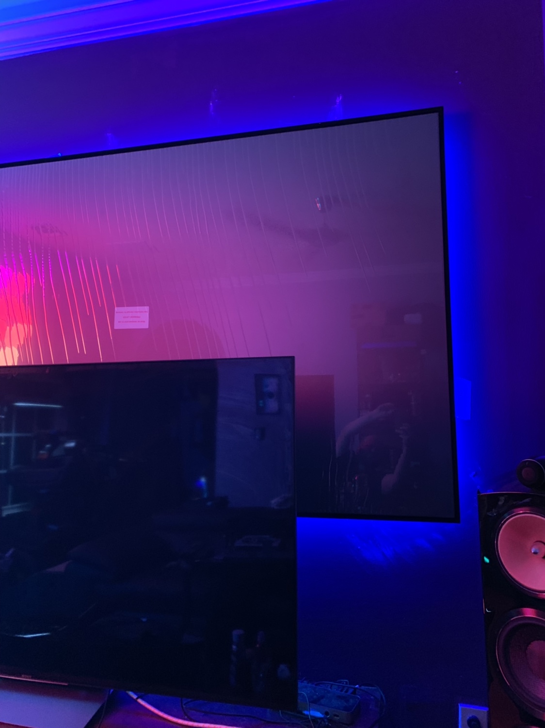

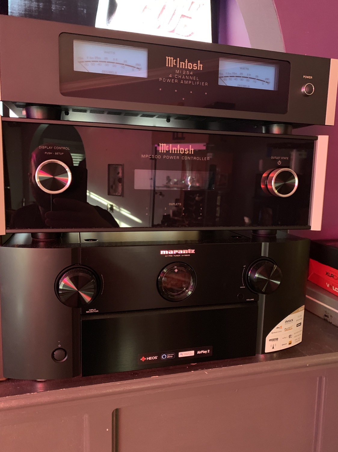

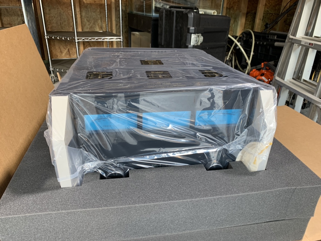

My room is almost exactly the same dimensions. Installing it now.... here’s my equipment list:
McIntosh MI254 (dig amp)
McIntosh MC303 (SA Amp)
McIntosh MPC500 (conditioner)
Marantz AV8805 (processor)
JL Fathom 13.5 (3000w)
B&W CCM7.5 (X2)
B&W CWM7.4 (X2)
B&W 804D2 (X2)
B&W HTM2D3 (center)
Sony VPL-VW695ES
Screen:
Screen Innovations Zero Edge Pro
Fixed-frame projector screen with ultra-thin frame and LED backlight, Black Diamond dark gray material (100")
Sent from my iPhone using Tapatalk Pro
