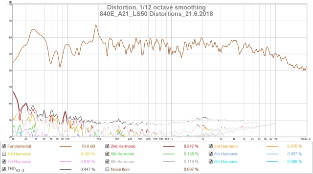

The Halo A51 on the S&V bench reached about 0.01% at 240 watts, I assume one can get an A21, the two channel version for about US$2,000.
So that's US$8.33 per 1 clean watt, but that's just the power amp. Matching it with a decent preamp will likely bring the $/watt to at least double that of the AVR-X3400H.
I have done hours of listening, comparing the X3400H to my Cambridge Audio 840E/Parasound halo A21 separates. I could hardly hear a difference in sound quality through the LS50, using high resolution digital files of recordings that I know are of very high quality. The speakers are most likely the bottleneck, but I highly doubt the two setups could sound different enough for most people to pass any properly done blind tests even if higher resolution speakers like the B&W 800 diamonds or Revel Salon 2 are used.
If one has a room that is far from perfect acoustically (such as mine),the AVR has an edge, because XT32 Sub EQ easily improved the bass response for my LS50+Rythmik sub setup. Before that, I had to spend many hours using minidsp, the sub's PEQ and multiple times of sub crawling, to get similar results that Audyssey manage to get in less than 15 minutes. The difference with Audyssey on and off is so obvious that I suspect even a kid can tell which one is better.
This is the quantitative/objective part. It is getting late in the day, so the qualitative part will be for tomorrow.
Edit: I changed the title because it is simply a quick review of this lower mid range 7.1 receiver, and potentially use it in a two channel system. It is not meant to be a replacement of a two piece pre/power amplifier system.

It may be too early to say anything conclusive, but so far I am impressed by its performance in that set up. By the way, you have been right all along, and I totally agree with you now, that if one only needs 2 to 7 channels, there is no need to pay extra dollars for the much more expensive X4400H, especially if it is used as a prepro.
Does Audyssey seem to work as well as miniDSP?
Absolutely, I would say better, you can see in the comparison graphs I posted. The black curve was Audyssey, first attempt, using 6 positions, with the sub's PEQ off, phase at 0, XO at maximum; and no sub crawling at all and without fine tuning with the editor app. The graph looks as good or better than the one for using REW with the minidsp, plus the laborious effort of subwoofer crawling.
Do the FR plots for the Denon AVR-X3400H Receiver look identical to the Separates Preamp?
Using 1/12 smoothing, the two curves sort of look like one for the most part, virtually identical.
I know you won't care about the subjective part of my review. So, suffice to say that I've tried very hard to listen for the presumed harshness, brightness etc., that audiophiles might expect from an AVR. Surprisingly, or not, I am hearing the same smooth and neutral sound that I hear from the separates, be it violin, percussion, brass, or even pianos. My reference is always live music.
I am going to spend many more hours listening to music that I am very familiar with, before I decide on using it in the HT room or not . Either way, I will likely keep the AV8801, now that I know Audyssey is able to tame those big bumps in the lower mid range. It also managed to improve the nasty dip at around 85 Hz to an acceptable level. Regardless of those graphs, the bottom line is, I have never heard the LS50 sounding that good until now.
