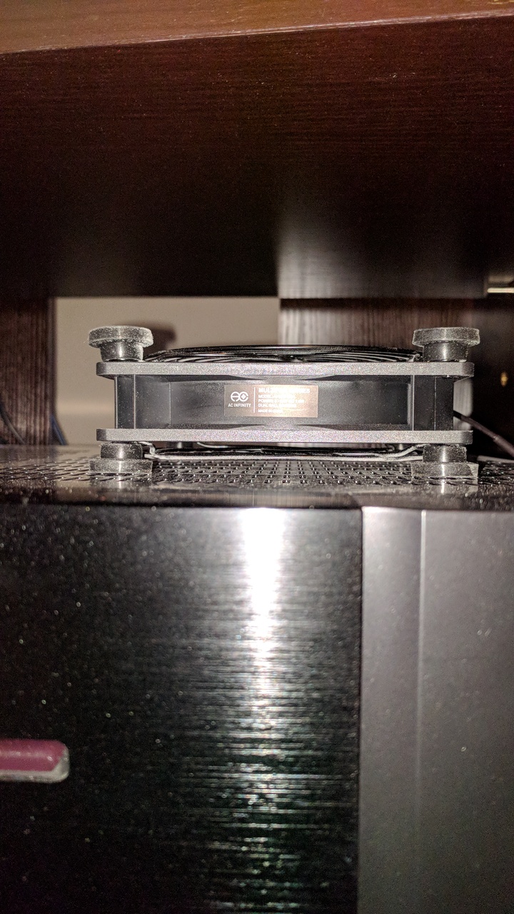

Got my fans yesterday. Did not do any measurments but noticed a couple of things. They are really quiet even at high spead. They seem to be lowering the temperature under them but i can see just minor air movement above them. Is that expected? S7 advertised as 104cfm. Cant believe that

Andrein,
The easiest way to see how much air it moves is stand it up vertically on a table, and hold your hand across the output side when on high speed. It does move quite a bit of air.
Please advise what Receiver you are placing it on, or post a photo how you have it mounted. Then we can comment more.

Hi Jim,
I just put 2 of s7 fans flat on my a1070. Can take a photo later, but there is nothing special. I tried to test them in vertical position and could detect some air movement on one side of the fan but just from 1-2 inches at high speed. Beyond that there is nothing. Do you see more air movement with your fans?
Also they could make it more obvious which way the airflow will go using some arrows. So that you know which side to put the fan down. Otherwise you have to try and find out yourself. Right now my fans are up the side with small piece of red wire.

They are only 52 cfm each, 104 is for both together. The fans are quiet mainly because of the relatively low speed and the soft rubber feet. You should be able to feel the air movement though, even at medium speed. You can also see it by letting it blow to something light on top.
Try plugging them to external USB outlets rated 2 A or higher, instead of the one on the AVR, just to make sure they are not starved for current.
Yes, going to try external power supply.
