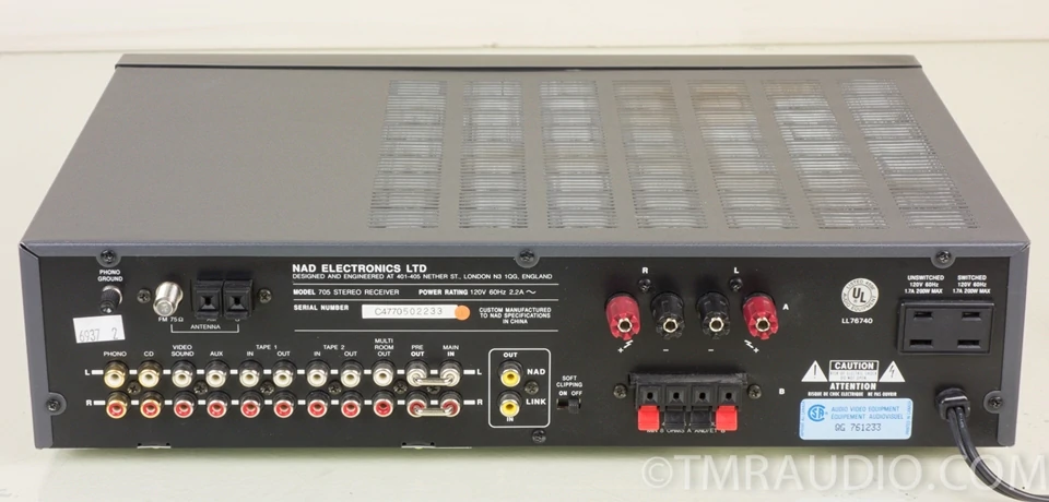

Is this your receiver?
If so, you can separate the pre-amp from the main amp and avail yourself of your sub's ability to filter out the lows.
The rightmost pair of red and white jacks have a jumper. Remove the jumpers (SAVE THEM!!!) and and run a stereo interconnect from the pre-out to the line level inputs of the sub. Then, run another stereo interconnect from the sub's line level outputs back to the main inputs of your receiver.
You should be good to go.

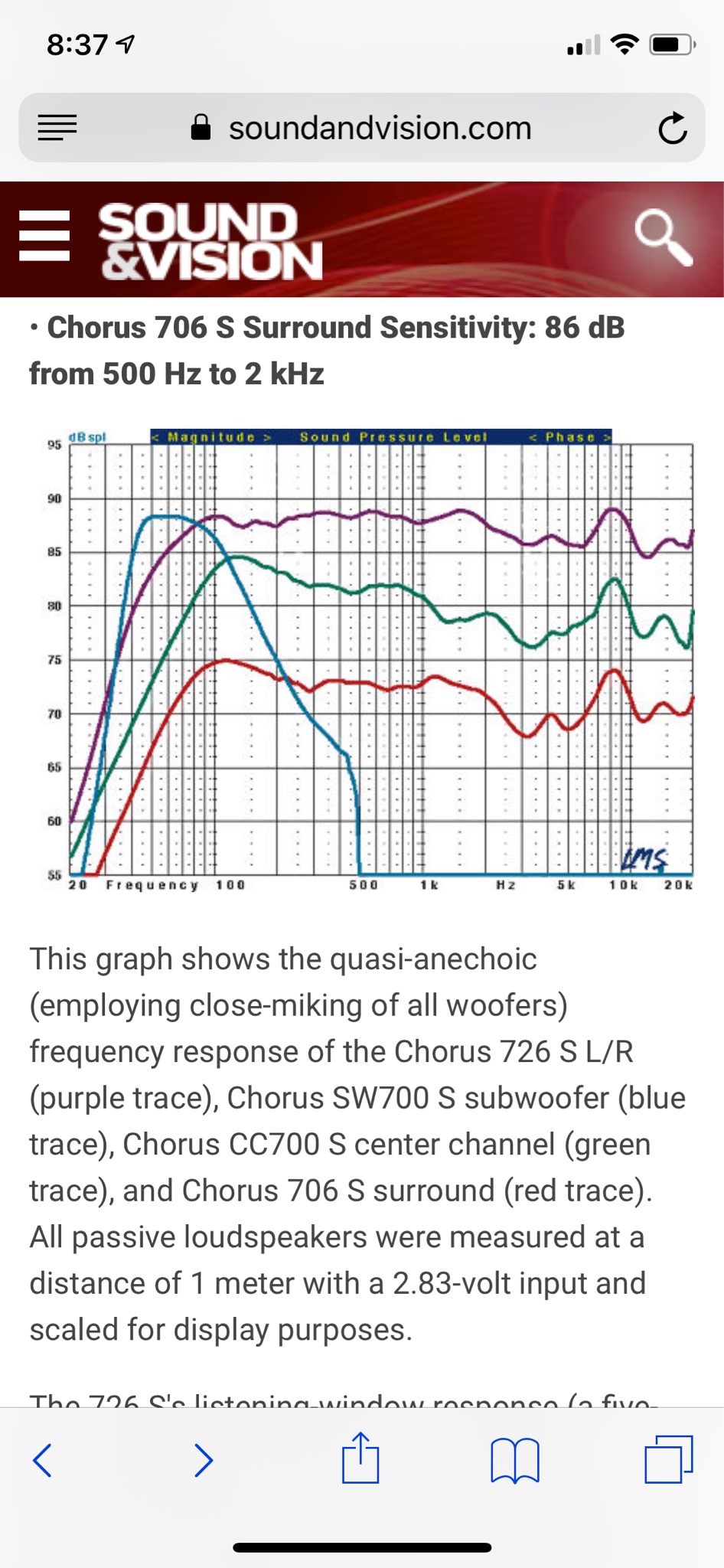

If I’m reading this correctly it looks like crossing it over just under 100 Hz
Any recommendations on where to set the crossover on the sub? I’m also guessing this will eliminate any frequencies below that level from being sent back to the receiver and amplified thus freeing up more usable power?
You only have the low pass on the sub unless you connect it with the low level (rca) connections. The high pass if you do use the low level connections is fixed at 80hz. If you're using just the low pass filter I'd place it near the f3 of your speakers (which the graph you posted doesn't show, as it's from 500hz and up) which according to their specs is 49Hz, but try above and below and see if you have a preference.
