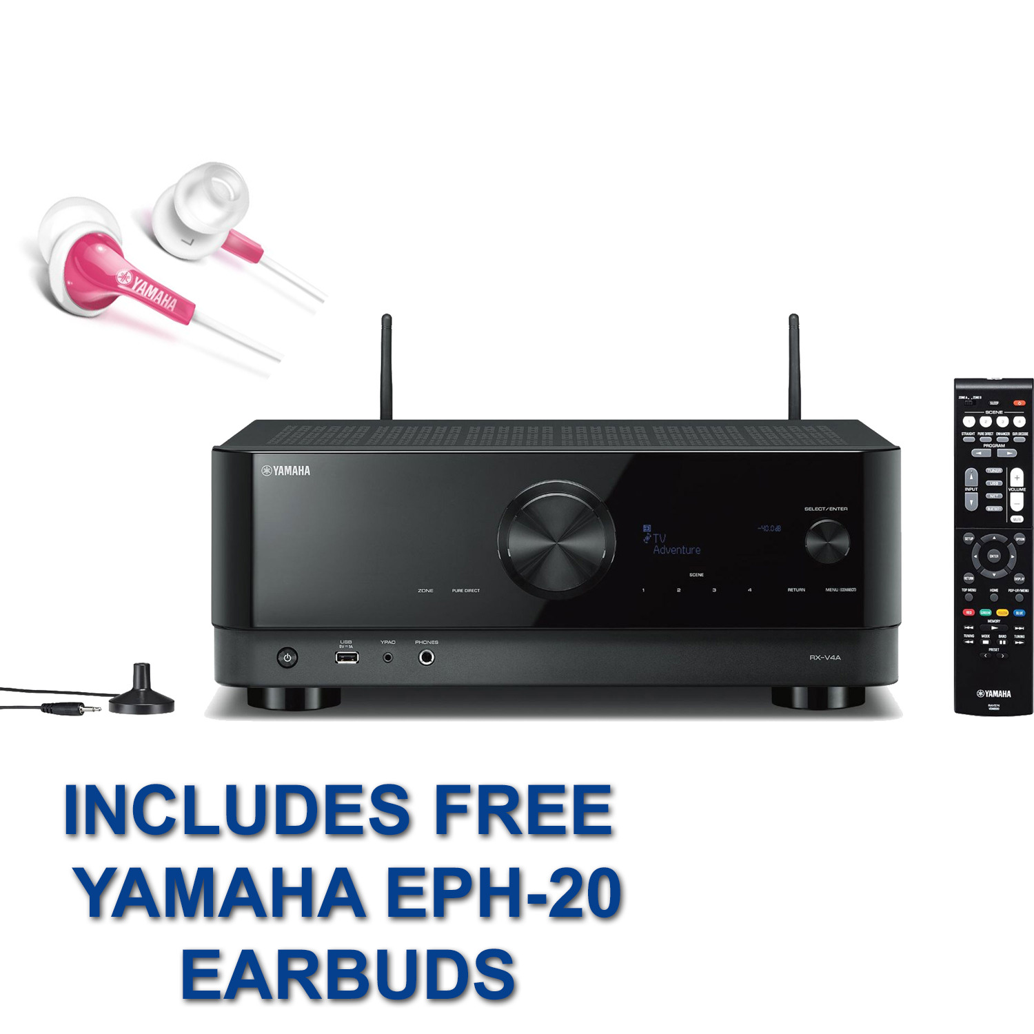

If you really are happy with your current speakers, then almost any modern AVR will do, and Accessories4Less is a great way to save some cash.
The factory refurb Yamaha V4A is only $350 from them and it works really well for a nice 5.1 setup...

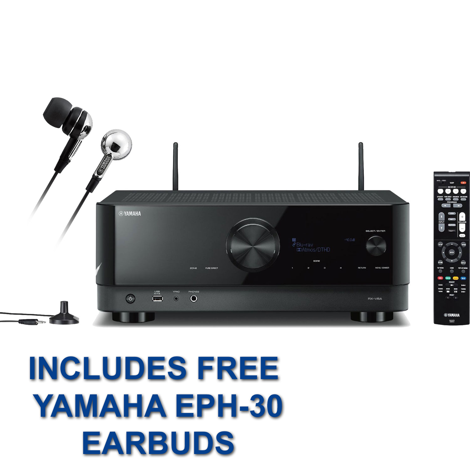

The V6A at $500 offers more HDMI connectivity and 7 channels of built in amplification. I think it hits a really sweet spot for features/performance/quality for the money.
You listed a $500 target, and the V6A hits it.

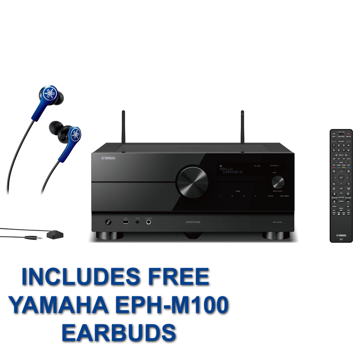

The V4A and V6A/TSR-700 Costco twin are 24Gbps limited and will not support 4K HDR @120Hz from the PS5's 32Gbps. Getting either of them means connecting the PS5 directly to the TV. This is why I suggested starting at the A4A. The A2A is also limited. A Denon S760H or Onkyo TX-NR6050 can both be had for $500 at Costco and support HDMI 2.1 at 40Gbps. Or, as was mentioned, a refurbished higher end model might be considered.

@Trebdp83 - Thanks for that clarification. In my opinion, if he upgrades the TV first and then spends about a year waiting, he would likely get an upgraded/updated version of AV receivers which support 40Gb/s+ HDMI in lower end receivers. It doesn't sound like he needs all the connectivity of the A4A, and at twice the price ($1,000) for a refurb unit vs. the V6A, it seems like it might be better to wait, and just use optical out from the new TV for a year or so, while saving money towards 'whatever' comes along. I'm sure both Denon and Yamaha will eventually give us full-on 48Gb/s HDMI connectivity, but we all have to wait for chips to catch up to the standards.
I would be hard pressed to spend $1,000 right now vs. using eARC connectivity as an option for the PS5.
The A4A on A4L...
