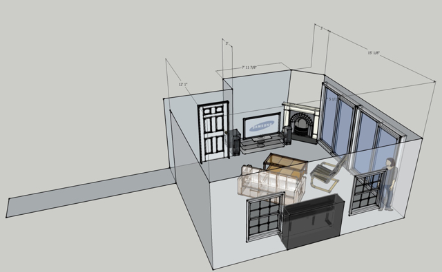

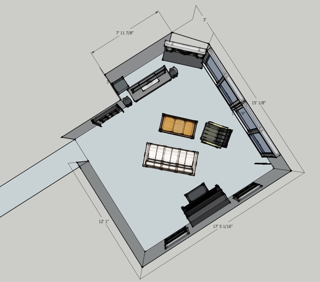

Room drawings:
A note about the images: I'm new to Sketchup so it's a bit "sketchy" and placement is close, but inexact. I gave up trying to place my two Klipsch satellite speakers in it. Both are pretty poorly placed but maybe MCACC has helped that.

Trying (and failing!) to be concise: I'm looking to upgrade my living room setup. I intend the room layout to remain essentially the same as in the attached image(s) but am open to suggestions that keep in mind this is a living space and therefore riddled with compromise. (Note: the space behind the couch is a cramped dining area, not a giant unused space awaiting conquest;)). I'm looking for a solution that can accommodate 2.0/4.0 (extended stereo)/5.1.
Some tricks about the room: its pretty much square with a hallway at one end; the floors are hardwood. I have a pair of massive Dahlquist DQ-10s but they need repair and they really can't fit in the room by any configuration I've thought up; a shame since in the few minutes I hooked them up a year ago I fell in love again with a kind of sonic depth and warmth I'd forgotten and can't forget again. That said, I'm no audiophile. I have an unfinished basement I'd planned on making an HT/listening area, but have since decided that in the next few years I'm selling the house and would rather not make that investment.

Basic floor plan change:
