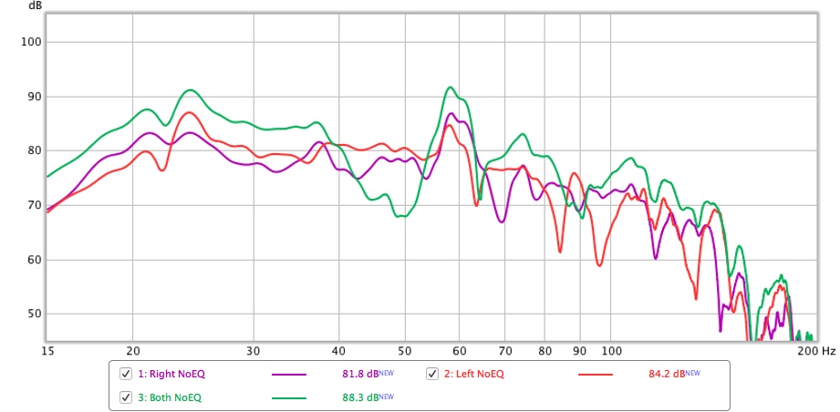

Well I managed to fiddle around with placement/some measurements today... not quite sure what to make of this.
For the most reasonably flat response, they ended up around 1/4 wall when measured individually. When they are both run together, they appear to be cancelling each other out??? depending on where the phase switch is set (i.e. I get a fairly large null that moves around depending on how I fiddle with the phase).
Should I just try to co-locate them?

How did you determine a null. REW, spl meter, just walking around etc.
REW. Power one off, take measurement, swap power to the other one, take a measurement, power them both on and take a measurement. The dip shown here at 40-50 can be shifted around by playing with phase controls.
With your subwoofer placement, with subs on opposite sides of the room with the listener in the middle, its not surprising that you get that kind of cancellation with two subs. You are sitting in the middle of two equal pressure wave generators, and that could make for some severe interference patterns. That 50 Hz centered dip is a problem. Of those curves, the red one is the best, since the cancellations occur above the crossover point (assuming you will be using a 80 Hz crossover).
Is there any other locations that you can try one of the subs in? perhaps a near-field location, like right behind the seat?
