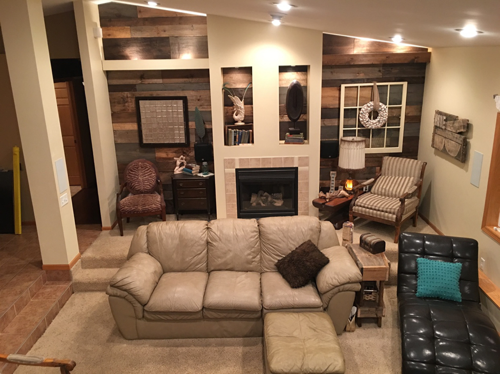

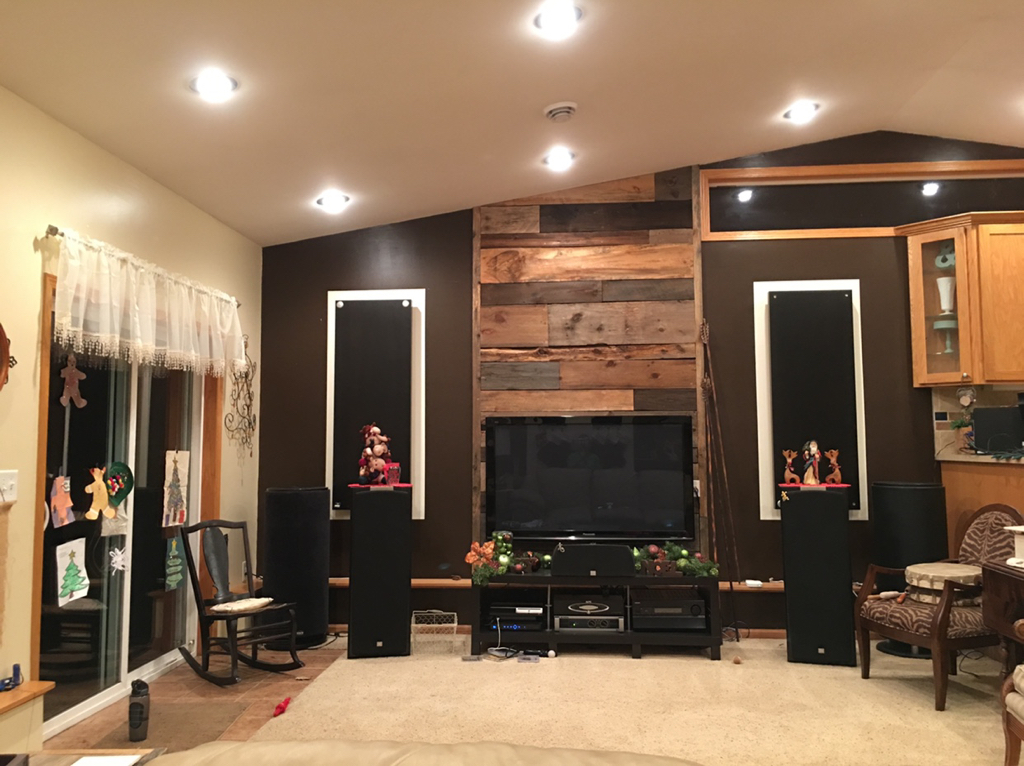

Here’s a couple shots of my ceiling just for fun.

I attached a couple pics(last post) of my ceiling just so you can have an idea of what I’m working with. May or may not help with your WAF but I’ll leave that to you. Lol
Nice setup boss looks great! ..... Now how big is your TV HUH?! Lol
L. M. A. O.
Yep danno, my little tiny baby is a 58”er.
it kinda disappears on that 16’ wall.
No need to rib me too hard though, I have a projection scheme in the works. I think my wife even likes it!

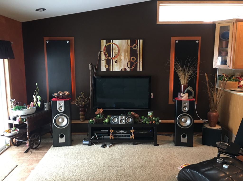

If you don't mind me asking what towers do you have there? Just curious I could swear they look like JBL's I'm getting super curious about there studio 590's I think I got the name right I really like the look of them I can't get them out of my head
William Lemmerhirt
William Lemmerhirt
Good eye man. They are indeed JBL studioII s-312 designed by none other than Greg timbers and use a French sourced titanium tweeter complete with 12” woofers. While definitely not the be all end all speaker, they are really great and I haven’t had a lot of reasons to upgrade them since IMO it would cost a bunch to get much better. I did consider the 590’s as well. They look suuuuper cool and from all accounts I’ve heard, they sound great. I also think they look awesome, and have a very unique look. I follow most of the brands and when the time comes, I’m not sure which brand I’ll choose although I have always wanted a pair of gorgeous towers by legacy. revel and kef intrigue me too as well as philharmonic and some others.

Danzilla31
I have experienced a bunch of different JBL’s through the years and for the most part I think they offer really good value.
Your speakers are super super cool man. I love JBL like you said they offer great sound at a great value. I actually love horns if they are done right and JBL is one of the ones that does them right.
I'm on my SVS trip now but man if those JBL 590's go on sale next year for friggin $500 apiece again I might just have to put three of them up front and go with 4 of the 580's for my surrounds. That would sound friggin epic in my room.
I love the soundstage and directivity and dynamics and clear clean highs a really good horn can reproduce. For a long time the best ones were just really expensive but JBL And some other companies really brought good horn loaded speakers down to our range. And for my main room being mostly movies with music in the office set up and bedroom well sh@!!t that would be a sweet sweet setup.
The only thing I worry about with upgrading ultra's is the woofers being on the bottoms side firing. That front wall already has a tendency to have too much gain why I had to relocate the PB 4000's I'm worried about some bass bloat and muddying with the Ultra Towers the way there built like that
Hence my current obsession with the 590's! :D
