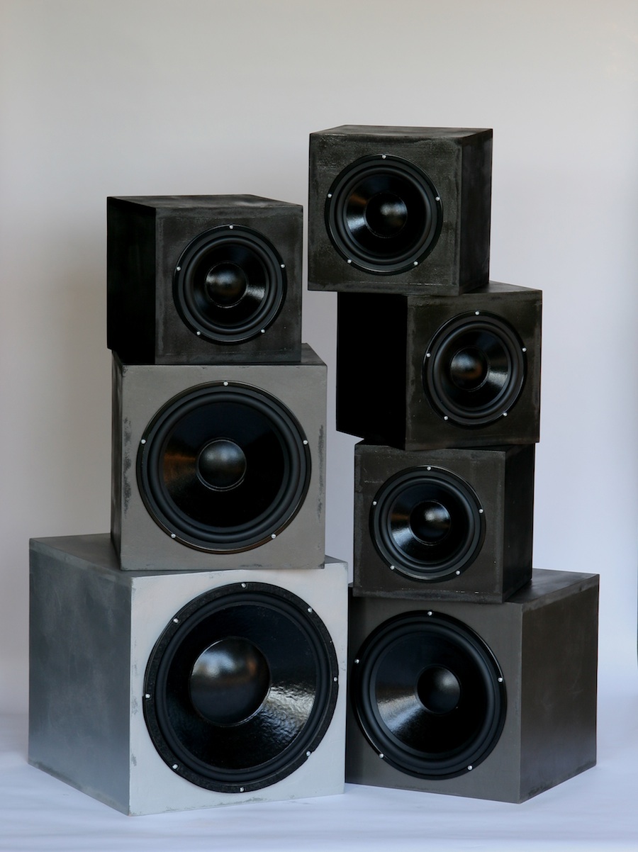

The Motion 60XT's are nice speakers! You can certainly buy better, but having a single 10" sub stands out as the biggest area of weakness in your gear. I am inclined to go with a minimum of a 12" sub even if it is just for music, but if you feel like the Dynamo is good for the bass content in the music you listen to, it is much more practicle to get a second Dynamo.
Understand that the frequencies subwoofers produce set up standing waves in any typical residential room resulting in areas of the room where there are nodes (spikes of too much bass) and nulls (areas where the bass is cancelled out).
here is a pretty good read to introduce you to this if you are not already familiar with the case for multiple subs.
