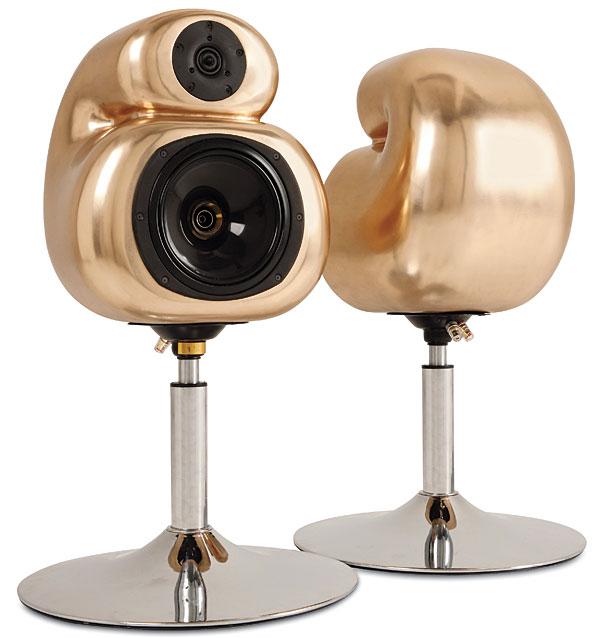

Yeah, don't forget about the $5 mil turd shaped gold speakers "Aural Pleasure"... snicker.
,my turds are much better looking that those .........
The irony here is that those speakers are likely better performers than any of the others on that ultra-expensive speaker list. It looks to still have a problem; that woofer is just too large to mate well with that tweeter. That woofer looks like an 8" or 10", so that speaker will have a significant directivity error.

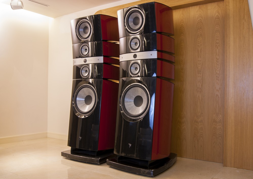

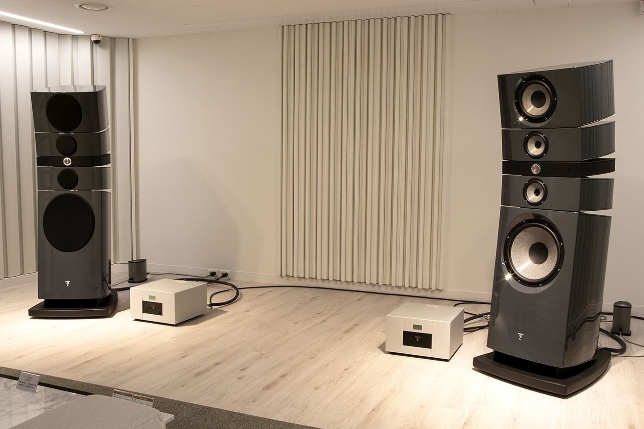

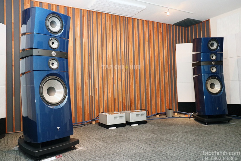

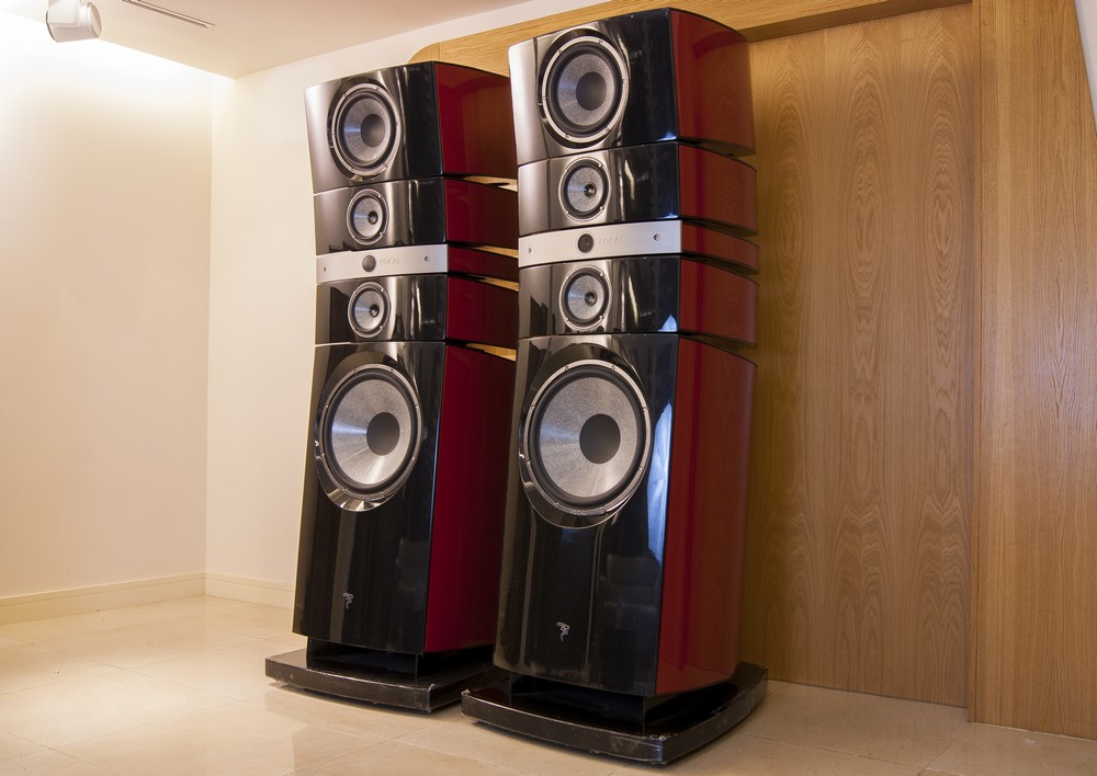

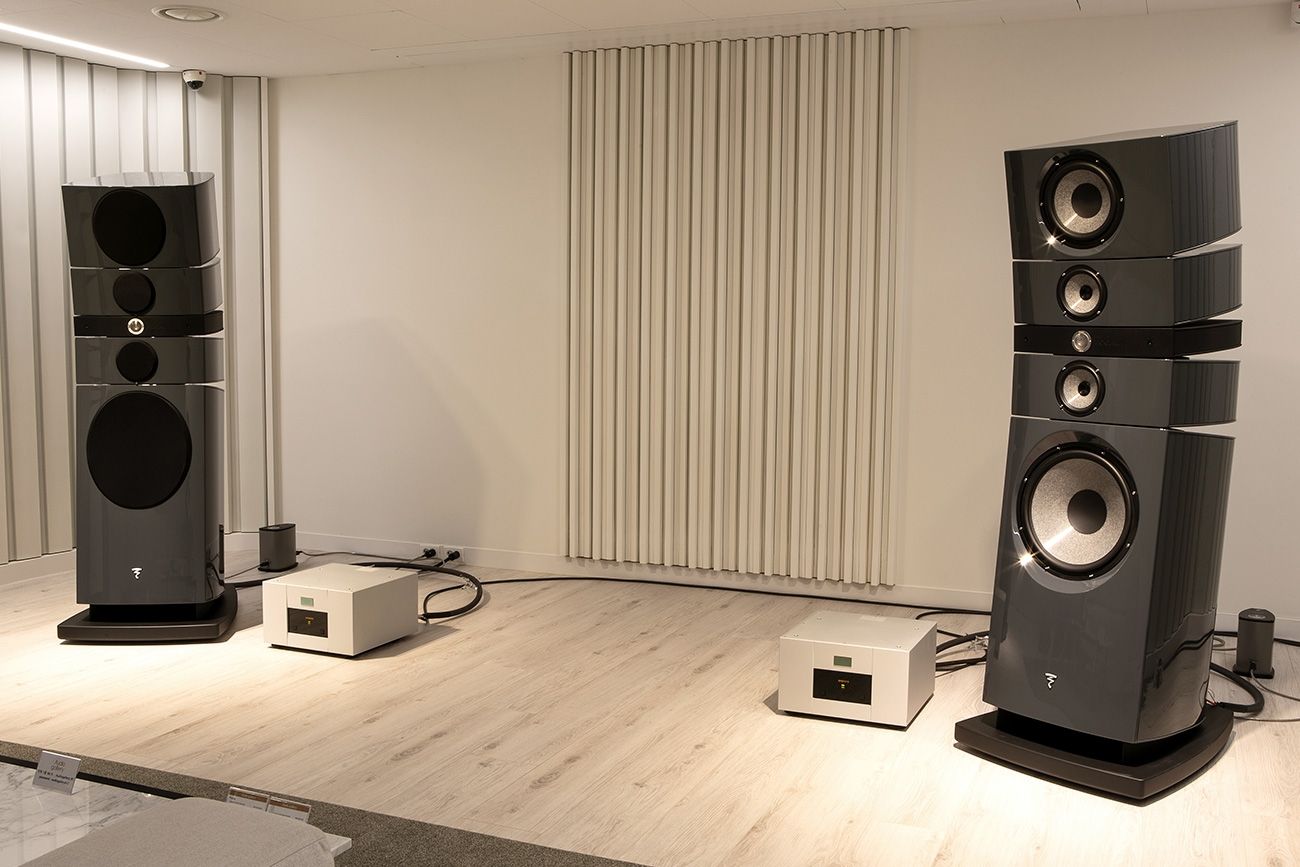

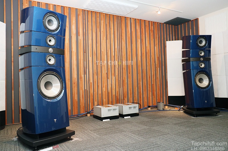

Focal make some really eye catching speakers for the filthy rich and are known for making legit, great sounding speakers. I'd love to own a pair of the Grande Utopias. At over a quarter mil/pair it's just pie in the sky for me...
I think I read that's actually a dual concentric driver paired with a Vifa supertweeter. There's more going on than just a big woofer and tweeter.
View attachment 46668View attachment 46669View attachment 46670
I have heard some of the Utopia speakers, those are legitimately good loudspeakers, despite their cost.
Ok, that concentric driver should solve the directivity problem at least. The dumb thing is the compartment for the supertweeter is large and weird looking and is a bit distant from the coaxial driver. They shouldn't have made such a big deal out of the supertweeter and merely given it a small mounting on top of the coaxial driver mounting. That would have looked better as well as functioned better. This speaker didn't have to look like a turd as mikado eloquently stated. What the hell was the designer thinking?
I've heard these. They're awesome. 600lbs each. And just to make @TLS Guy shake his head, they have an 80Hz passive crossover to that 16" subwoofer driver.
Man, I think focal makes some of the most beautiful speakers around. But every time I see those I can’t help but think of these guys.
I spent a while one afternoon looking up info on them and determined that if I ever have a spare quarter mil to spend on speakers they'd be on my short list. I love the way they look, and they review really well.
And that is still very bad engineering. The whole problem with many of these exotic speakers, the design principles are just so often wrong, and defy basic principles and logic.
