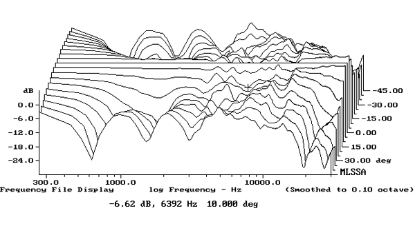

The mid range and higher seems to be good, on-axis. But off-axis, above roughly 1.5-1.7 kHz, the response drops significantly. See figure 4. It's dispersion and imaging must suffer. The reviewer didn't talk about that, and I wonder if his small room might have hidden that.
Both the reviewer and JA noted the bloated bass, but didn't comment any further about it. Why was the bass response mis-tuned? Was the cabinet too small or too large? The F3 by my eyeball is about 40 Hz. If the cabinet's bass tuning is cleaner – without any bloated bass – would the F3 be higher, say at roughly 50 Hz? Would a higher bass roll-off frequency have a negative impact on sales?
And finally, JA noted that with his measurements, the speaker's sensitivity was 87.5 dB, some 6.5 dB lower than the manufacturers value of 94 dB. That's a big difference.

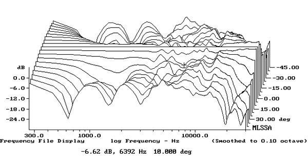

One thing that does surprise me about his tweeter array is the narrow vertical window. I know it’s somewhat common for MTM configurations, but how can you have a narrow window with all those tweeters!! Almost defies logic. There’s got to be some big-time cancellation going on
The narrow vertical window is due to the placement of the woofers relatively far from each other. The large circular array of 7 tweeters between them takes up more space than a single tweeter. This distance between the woofers causes the cancellations, as the listener changes position vertically. See three cancellation troughs, centered at roughly 600, 1500, and 3000 Hz, in figure 5 in the Stereophile review of the Tekton DI monitor:
"In the vertical plane (fig.5), the use of two woofers spaced relatively far apart leads to major cancellations in the midrange above and below the response on the central tweeter axis, which again appears as a straight line. The Impact Monitor's vertical radiation pattern suggests that the speaker needs to be listened to within a narrow window centered on the central tweeter axis if the midrange balance is not to sound colored."​
One issue to keep in mind is that there is a distinction between uneven vertical dispersion--caused by cancellation modes--and limited vertical dispersion, where the response drops off smoothly above and below the speaker. If the drop-off isn't severe enough to mandate a head-in-vice listening position, it's possible that there are sonic advantages to limiting vertical dispersion. A local electrical engineer and I are trying to get to the bottom of that question with a large tower speaker that is designed to control vertical dispersion without introducing serious driver cancellations. I've worked out the crossover for the simpler version, and am going to try my hand at a more complex and sensitive version. It should be interesting to compare these speakers with conventional towers.
What do you think the advantages of a narrow vertical dispersion would be? I would think that, so long as the response isn't badly non-linear, it should sound pretty natural, much like lateral reflections. Of course, the vertical reflections of many speakers are far from perfect. I do remember reading about some study that was done on the effects of ground bounce cancellation in bass, and in the end it wasn't very deleterious because like many acoustics issues, human hearing seemed to adjust for it very quickly. Floyd Toole discusses it in his book, although I don't have my copy handy so I can't site the specific paper at the moment.
If the drop-off [due to limited vertical dispersion] isn't severe enough to mandate a head-in-vice listening position, it's possible that there are sonic advantages to limiting vertical dispersion. A local electrical engineer and I are trying to get to the bottom of that question with a large tower speaker that is designed to control vertical dispersion without introducing serious driver cancellations. I've worked out the crossover for the simpler version, and am going to try my hand at a more complex and sensitive version. It should be interesting to compare these speakers with conventional towers.
Interesting. Conventional wisdom has it that our ears/brains readily adapt to floor & ceiling bounce. It may look severe in measured frequency responses, but it doesn't seem to matter so much to listeners. At least, that's what we're told. Those of us who live indoors are used to hearing things in the presence of floors and ceilings. I hope your efforts provide a useful answer to that question.
