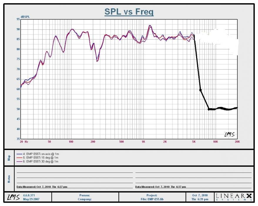

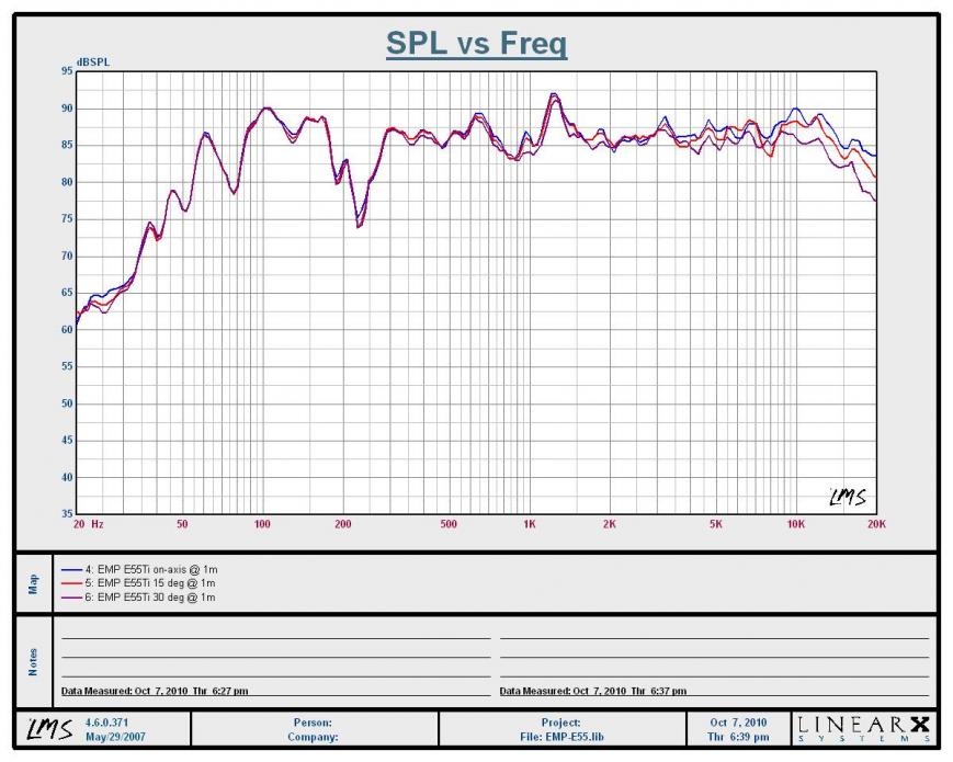

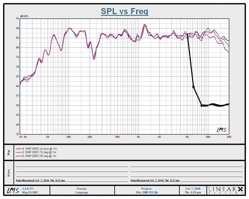

Gene's in-room measurement:
What my measurement would look like in my room (applied to gene's curve; -25dB from 5k to 6.3k and another -9dB from that to 8k)

Lol never had a party at this house or with these speakers. Even then, the tweeter is crossed at 3kHz so its not the tweeter alone. Plus this pattern happens on every single speaker.... And from 1 foot or 1 meter or 12 feet away so it's not a room issue. I'm at a loss

I will try that, but I don't think that's the problem. When I run MultEQ XT and look at what it did....it boost the top end like CRAZY. I'm talking 3-6dB across the ENTIRE tweeter section. I'll take a pic real quick and try PURE DIRECT

So with PURE DIRECT engaged & measurements taken from roughly 1.5-2' away @ tweeter height:
*these numbers are corrected from the SPL meter
5kHz: 74dB
6.3kHz: 52dB
8kHz: 43dB
Same thing. When I get within a few inches of the tweeter I can get 6.3kHz and 8kHz to give me 75dB-ish, which would make more sense....but obviously I don't listen from 3" away.
With PURE DIRECT engaged, measurements taken from 2' away @ tweeter height using sine waves:
1kHz: 75dB
2kHz: 69dB
3kHz: 71dB
5kHz:74dB
10kHz: 41dB
