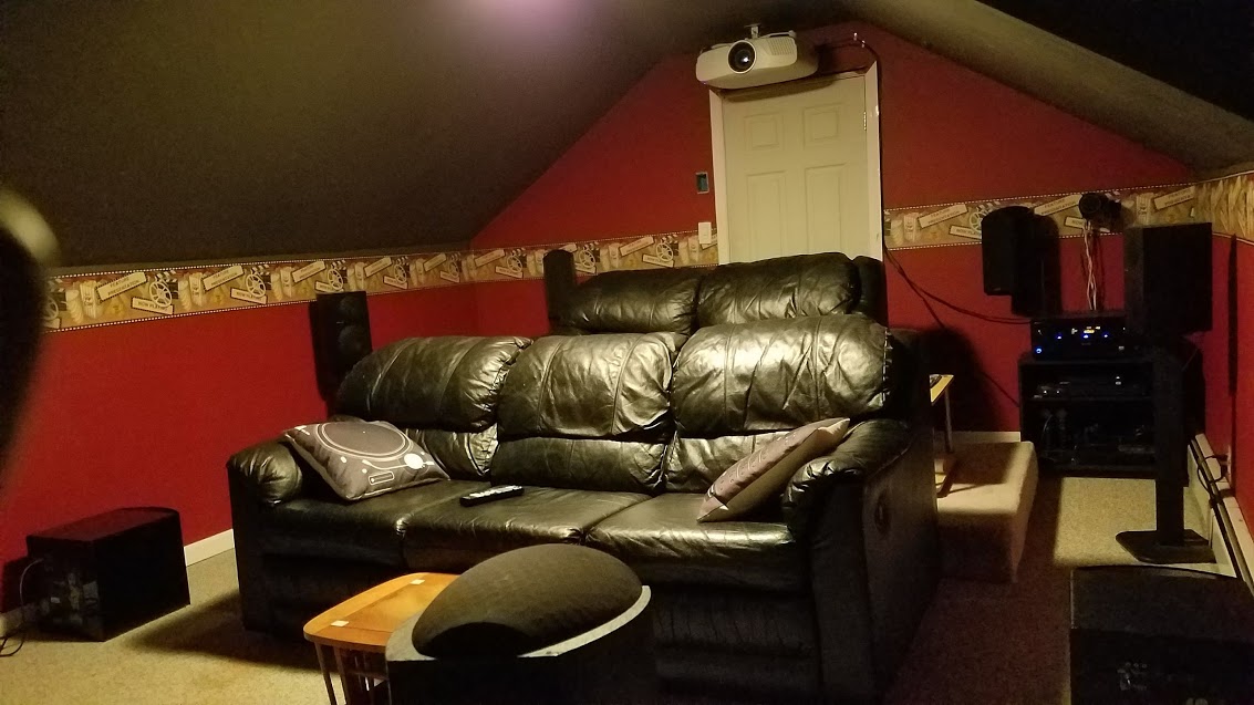

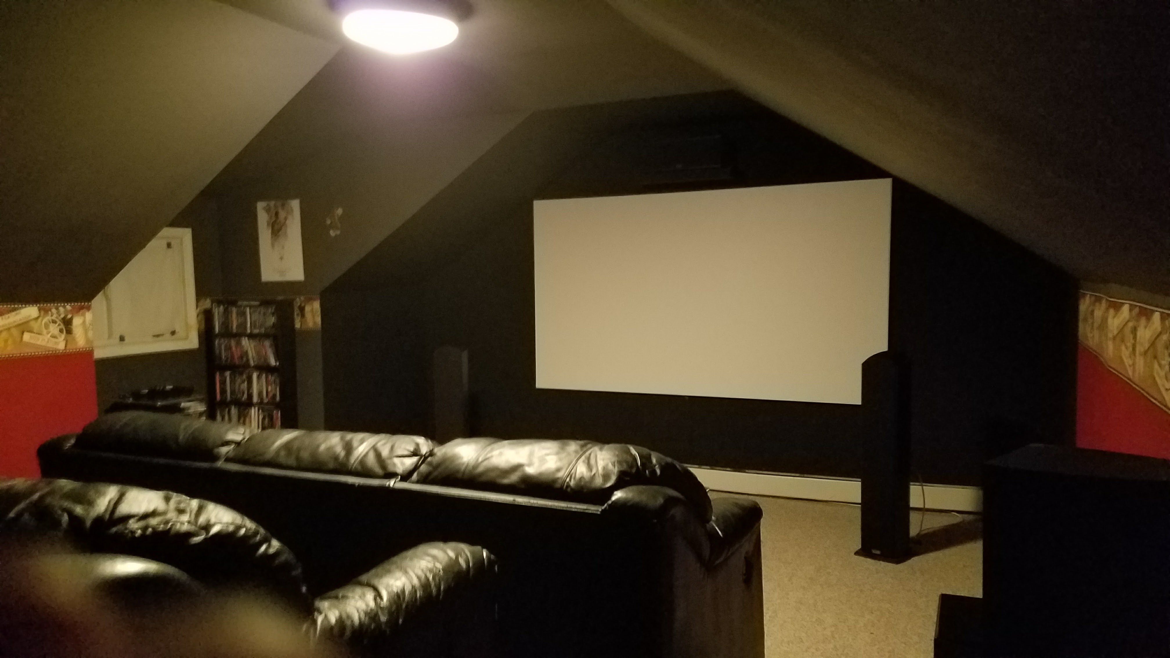

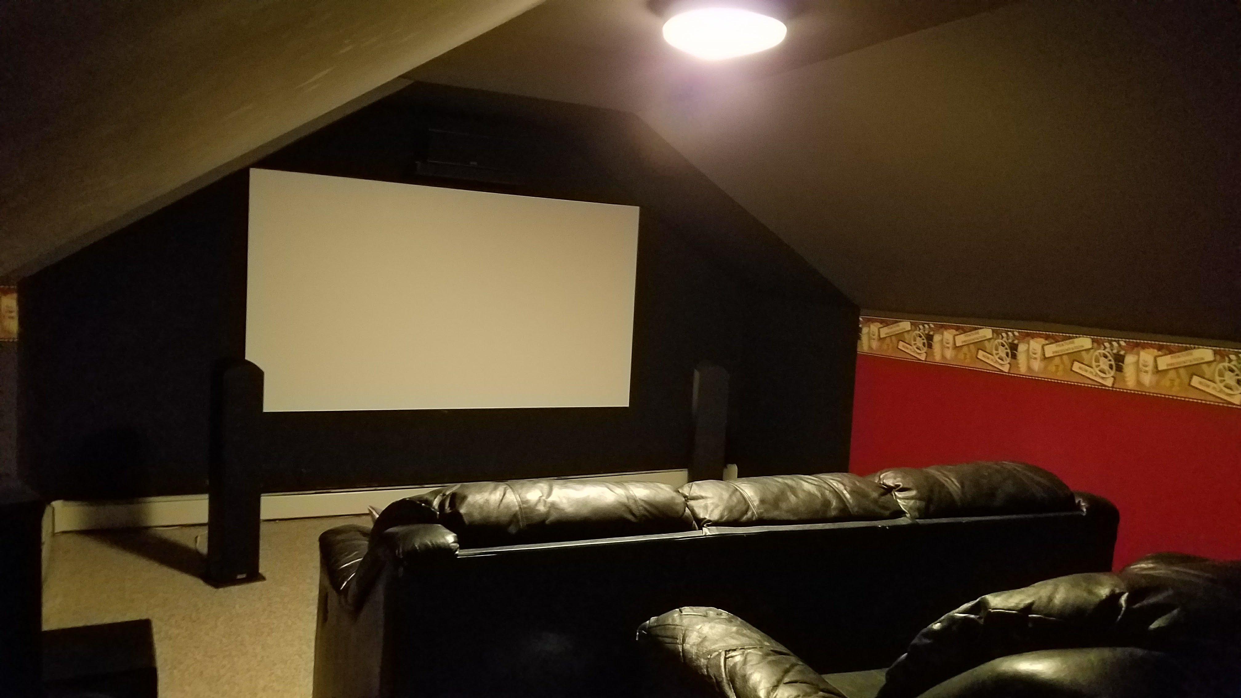

Thank you both for your answers. I've attached some pics of the room for reference. With regard to the 7.2.4 system etc, here are the specs.
  • Pioneer Elite SC-99 AVR driving the Left, Center, Right, Side Surrounds and 4 atmos enabled speakers (it's 11 channels but only 9 channel with amplification).
  • the Surround Back speakers are driven by an AudiSource AD 1002 amp.
  • The speakers are Andrew Jones Pioneer Elite SP-EFS73 Mains , SP-EC73 Center, SP-EBS73-LR Rear Surrounds, SP-BS41-LR Side Surrounds & Dual SVS SB12-NSD Subs
  • ELite Screens Edge Free Aeon Series 100 inch Cinewhite Screen & Epson 5040UB Projector.
  • The sources are Nvidia Shield (2017) streaming box, SONY UBP-X800 4K UHD disc player

View attachment 23755 View attachment 23756 View attachment 23754
That looks like I thought. That type of room usually has excellent acoustics.
Those Pioneer speakers are probably competently designed, so I wouldn't be so sure that Audyssey could help anything. You can try it both with and without Audyssey and just keep whatever you like the most, but don't assume that Audyssey will necessarily make things better. Audyssey is a band-aid for flawed speakers, not a magical upgrade in room acoustics.
