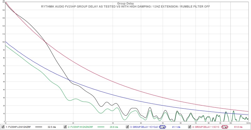

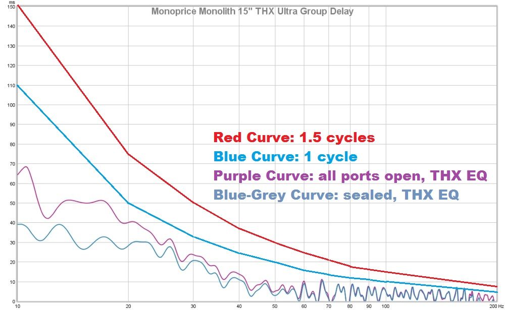

I find the group delay measurements especially interesting.
The Monolith shows superior group delay despite Rhythmik's much vaunted servo tech. Not that the FV25 is bad. It's more than acceptable. Inaudible for human hearing, but the Mono THX 15" is still just a little bit better through the deepest frequencies, staying below 1 cycle for the entire operating range.
I am not sure how Monolith does it, but they manage to keep group delay under a cycle at port tuning, which almost defies how ports work as I understand them. Port output should always lag at least one cycle behind woofer output. My guess is that they are using DSP to alter the phase of the input signal around port tuning to compensate for the port delay somehow. Obviously, this wouldn't be possible on an analog amplifier.
The much vaunted servo tech is to protect it from being over driven and not to control group delay. And since Rythmik keeps everything in the analog domain, there is no DSP control that can be used to lower it as Shady theorized for the Monolith. I also dont see any value driving the group delay further into inaudbility as long as it remains inaudible.
Ah, see I learned something. I always thought the servo tech helped reduce group delay too. It's been a while since I've read up on it.
