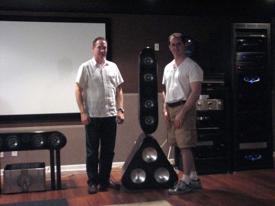

I think this was when Gene hooked his Status Acoustic 8T's to the Outlaw if memory serves.
The 8T's are a ridiculously difficult load, dropping to something like 2.3 Ohms (but if you are using speakers that cost $50,000/pr, you probably have $4,000+ for an extreme amp). As I recall, he was impressed that the Outlaw could half-way drive them.
But that has nothing to do with your question.
The answer is that the Status Acoustics have a different way to separate the drivers than any normal speakers. Sorry that my technical details are sketchy, but I suspect someone will be along to get more specific before too long.
I believe @AcuDefTechGuy may be familiar with the difference that makes the 8T better suited for bi-amping.

This is the speaker Gene bi-amped:
