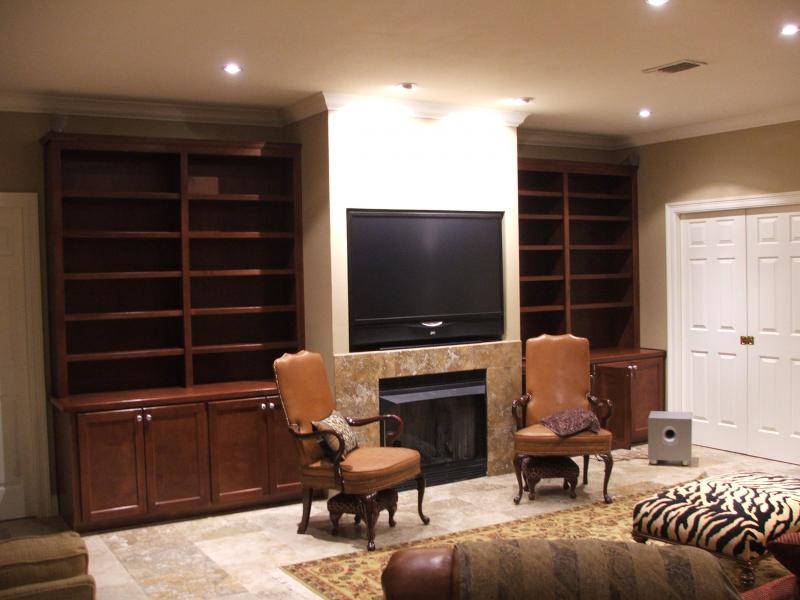

Is that your room??

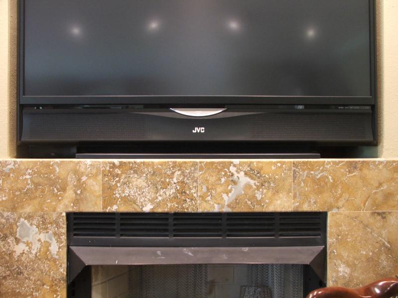

If so, I think it deserves a much better audio system than that JVC :)
mike c
mike c
whats that below the tv? fireplace?
it might not be a good idea to hide the speaker behind anything, you'd be cancelling any benefit of having a better speaker than that of the TV itself ...
I would simply suggest you get better front left and right speakers. and just set the receiver to "NON" center ... it will then matrix the center using the left and right speakers.

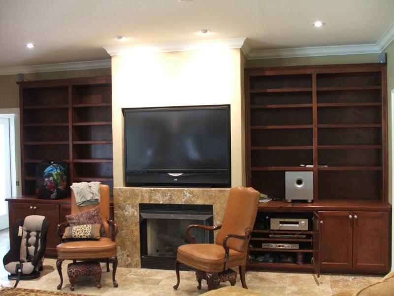

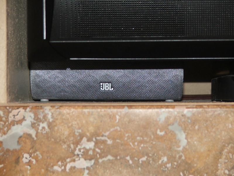

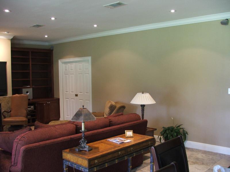

Well, I am not trying to go all out on this setup. I didn't have a lot of money to spend in the first place, so an additional center speaker is the only option I really have. The room as a whole (24' x 24') is not really condusive to a surround system anyway. As you can see, I have the L & R speakers on top of the book shelves. Similarly, the surrounds are mounted along the crown mould just slightly behind the couch. The sub will have to sit on the counter top once I drill a hole for the line from the receiver. So as you can see, I dont really have a place for 1 centre. But because the TV sits up raised slightly (about 3 inches) I have the current center sitting behind the screen so that the sound still comes out pretty well (its not like I am going to get THX certified!!). My main question was just if this would cause any problems with the Receiver, etc...

Actually, since you were already willing to compromise the visual integrity of the room by having a large television installed in the wall such seen in the attached picture, it would seem like you do have a place for a center channel, by the addition of an even smaller compromise. Cut a rectangular hole above the tv and cover it with a fabric framed grill that mounts flush with the wall and matches the wall in color. Place a center channel behind the grill. The only evidence of a center channel will be a texture change in the wall across a small area. You can do the same with the cabinets and install better left/right channels, by removing the wood panels from two of the doors(on left and right) and using a matching cloth material mounted on a frame. These are standard techniques used to install proper surround sound into settings such as you have.

With the centres behind the tv, they cannot be seen, which makes this a nice option...

Yes, the speakers and satellites are only about 4 inches tall and 3 inches wide. The centre speaker is about 8" wide and 4" tall. You can see them sitting on top of the book cases and mounted along the crown mould in my pics above...

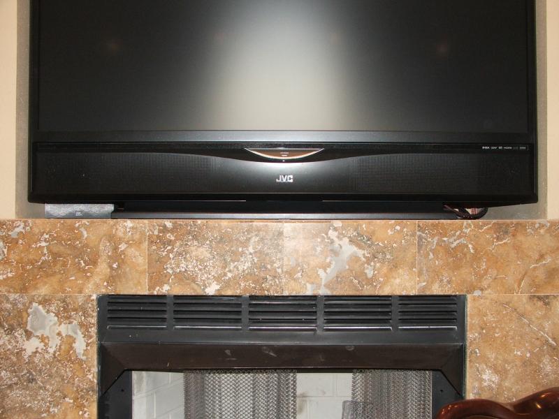

I think my choice would be to go with the built-in speakers over the JVC ones.

GUH! Can you not read?! Its JBL!
And I agree. Those speakers are FAR to small for that room. You'd be better off having all in ceiling speakers.

move the darn chairs and get some nice floors then you can install a shelf just above tv for center channel but I know WAF will stay no :(
Otherwise very nice room!!
