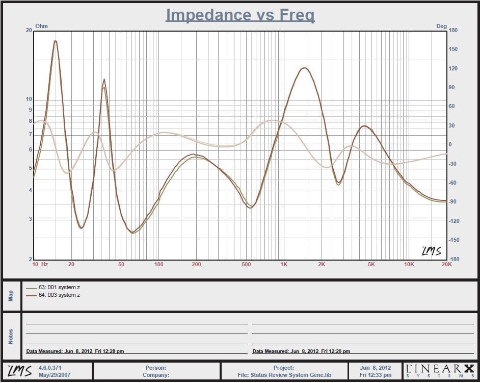

something is not right here. Perhaps your amps are lacking proper ventilation or your line sag is so drastic that the current demand on the amp is intense due to line voltage sag?
I successfully used the Anthem STR power amp to drive my Status Acoustics 8T speakers for years in a 6,500 ft^3 room at reference levels with LFE going to them and never had a problem. The 8Ts impedance dips to 2 ohm territory in bass and the Pass Labs X350.5 could NOT drive them as well as the Anthem STR.
see the Status 8T speakers:https://www.audioholics.com/tower-speaker-reviews/titus-8t-review
impedance graph: https://www.audioholics.com/tower-speaker-reviews/titus-8t-review/copy_of_GenesStatus8Tsystemz.jpg/image
I would say those big 8T towers aren't as difficult to drive than just the impedance graph alone might indicate, because of the good sensitivity, and you noted it even had a bump in the bass..., and, phase angle isn't horrible to that may help the average high power amps too.
From your linked review:
I measured about 92dB with a slight bump in the bass so their claim seems to be pretty accurate.
6500 cu.ft is big, but what's your listening distance, 4 meters, or 6 meters, or more?
Not saying anything bad about the STR amps, they are very powerful for sure, more powerful than the X350.5, for real world use for sure, when literally continuous ratings aren't as important, Anthem output specs for 2 ohm dips seems to be rated for up to 3 seconds, that's long enough. I would think real world contents rarely has bass frequencies the range shown in the impedance graph that would last longer than 3 seconds, except some rare huge pipe organ music. Again, amps like those are powerful, I am just being curious about the minor details, and, the typical marketing hype (such as "massive":)) that usually exaggerates things to make their points.
