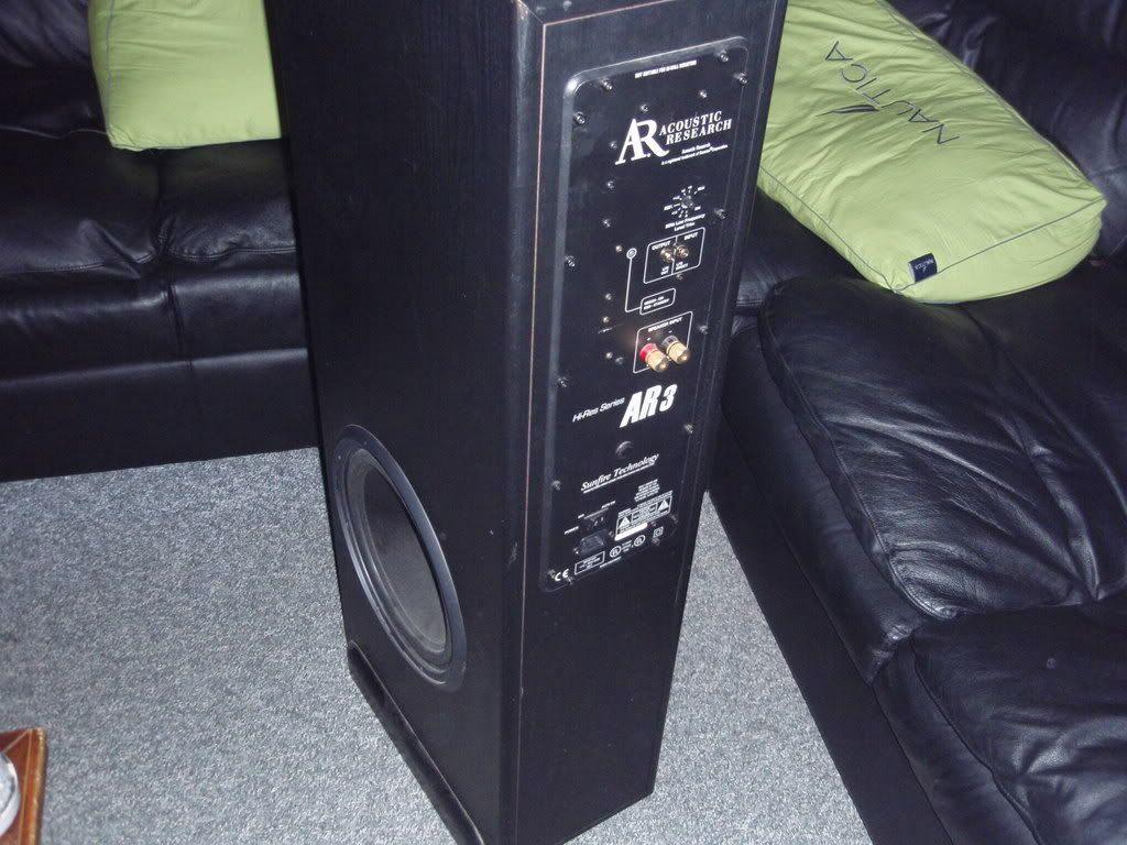

what i was frist thinking about was going with this 2 way setup to up grade the drivers in my ar3s with custom cross overs
so i can reuse the boxes as they have 12inch subs and sunfire amps in them
the mids are in a seald chamber about .4cf
Again you would not need the mid. I have been doodling with that 7 inch Reveltor for a while. Again you would need no mid, and just two Reveltors, you could go to four but look at the cost and size. It would make more sense to add a sub, or use a a couple of 10 inch drivers and the mid. I would caution you against a three way for your first project. Much more can and usually does go wrong.
Now that 7 inch Reveltor in a two and half way design would need to be mated to this tweeter.
