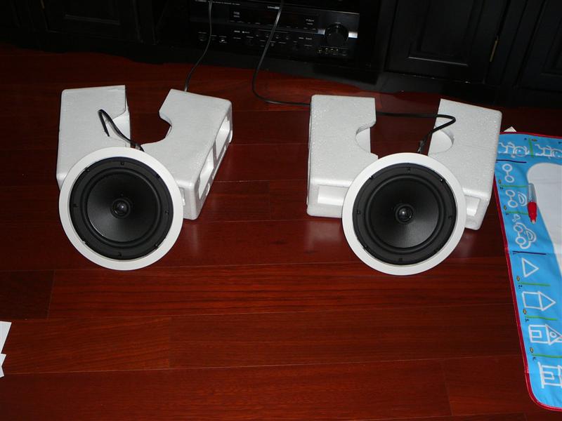

They were shipped Fed-Ex and arrived Wednesday. They were ordered Sunday night. The speakers came from Carson, CA. Packaging was standard styrofoam. Included were two cutouts/paint shields and a slip with warranty information. No manual was included because they are available for download off the website.
The sound quality is better than I expected. For $60/pair I'd not have any qualms recommending these for outdoor use. They do remind me of the Niles in-ceiling speakers that I have for my rears. Sound is recessed in the middle and lower ranges making them treble heavy.

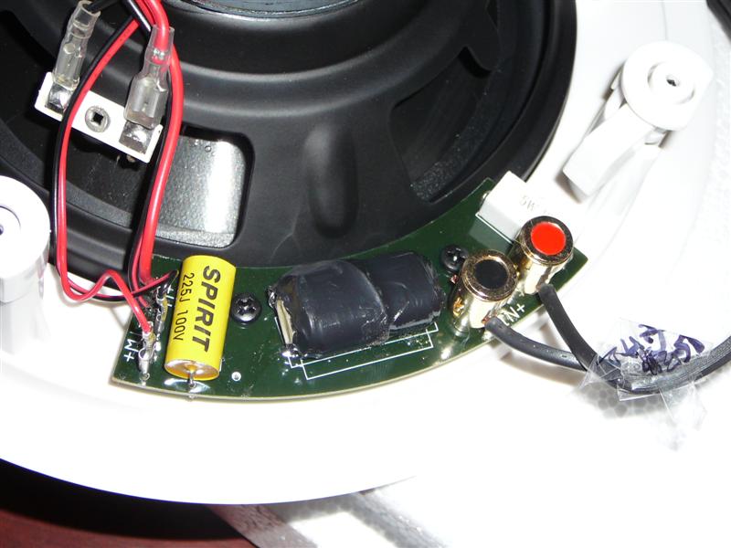

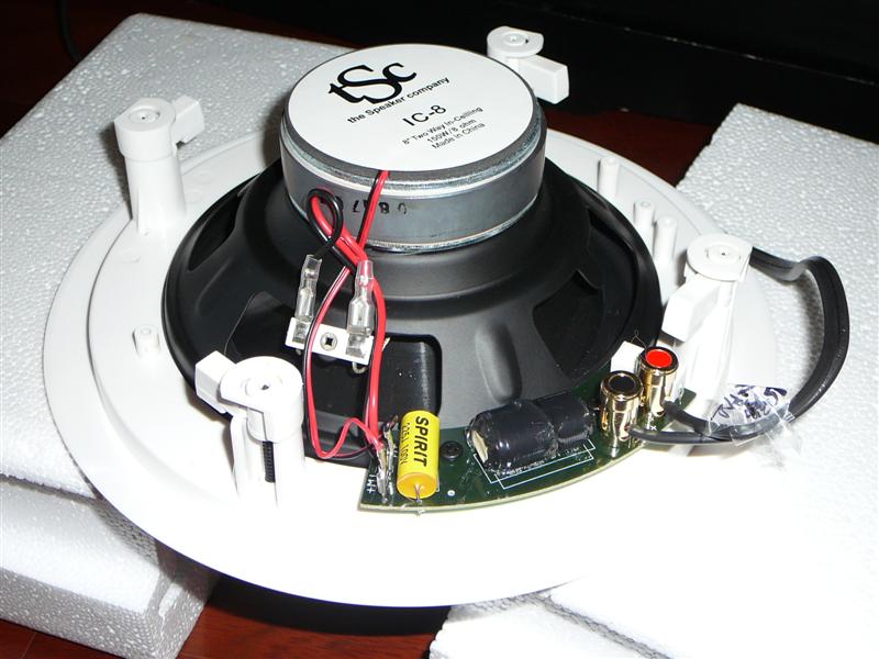

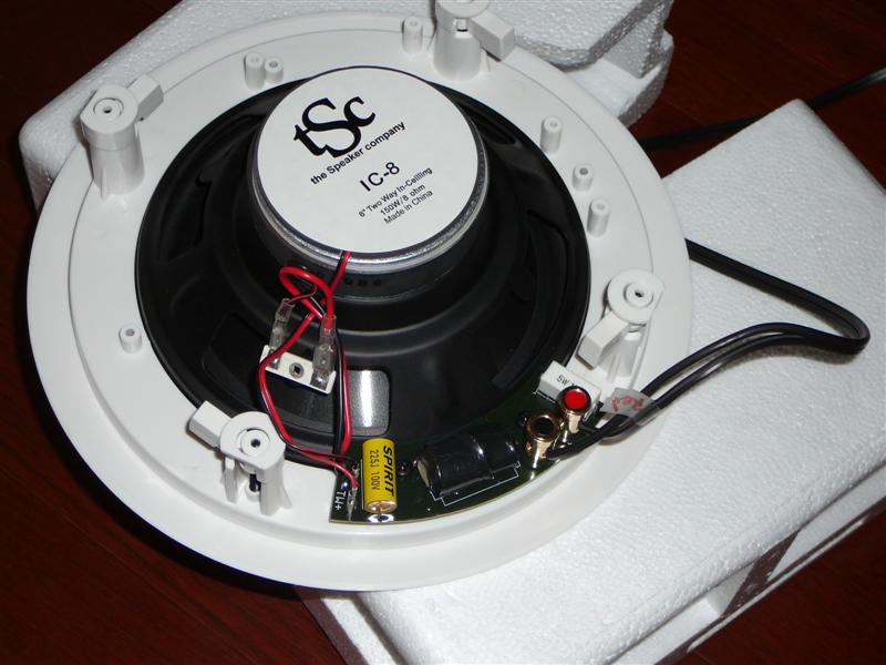

Tweeters are aimable and move very easily. They also are able to be pulled out of their socket with a little force. One arrived that way and I just snapped it back in. The wire connections are spring loaded doo-hickeys like push buttons. Same style as the stoppers found on hooded sweatshirt hood strings.
Interesting build point is that the wires for the woofer connection are thicker than the wires for the tweeter connection.
