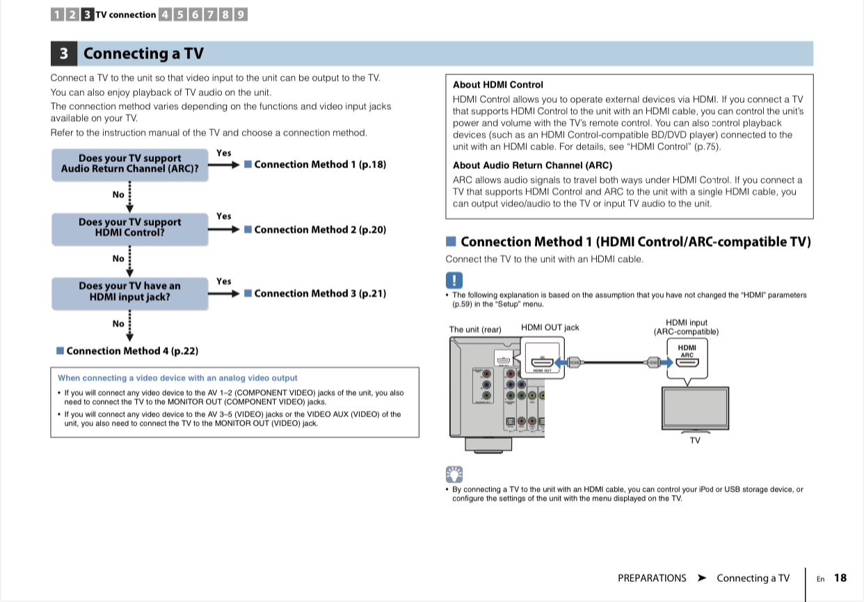

For reference, this is the back of your receiver:
Apparently this is how I connected the devices, I was mistaken above.
Cable box HDMI ARC >> Reciever HDMI 3
Reciever HDMI ARC >> TV HDMI ARC.
So the connections are not the problem..

Ok, figured something was off from your original descriptions. Using a Samsung TV and Yamaha receiver with HDMI-CEC and ARC is a nightmare on a good day. It is a very unreliable setup and I can tell you from experience that even if you get it set up perfectly, it will cut out whenever it feels like it and have you unplugging HDMI cables and power cords to get it working again. A much more reliable connection for getting TV audio to the receiver is using an optical cable. But, before going on with any more instructions, I would urge you to get familiar with the receiver. You need to know more about what it does and how it does it so that you can get back to a particular setting if changed by accident. So, read over the manual and get that optical cable ready. In the meantime, the clicking sound you hear is the amp switching as you go from stereo mode to a surround mode. If you haven't already, go into speaker settings and set it to a two channel setup with no subwoofer.

The audio will be fine. You have some options with the cable box connected directly to the TV and other options with it connected directly to the Yamaha. If you happen to know the model of the cable box, that would help. As far as HDMI-CEC, there is absolutely no real standard that all manufacturers are bound to and they can call it what they want, in fact. With no standard, it's anybody's guess when connecting different devices from different brands. Samsung would be very happy if everybody who purchased one of their TVs also purchased one of their soundbars and doesn't really care if Anynet+ works when connected to other brands. If you connect the cable box directly to the TV, the audio from it as well as audio from the TV's Smart apps can be sent to the receiver via the optical cable after making certain settings.
