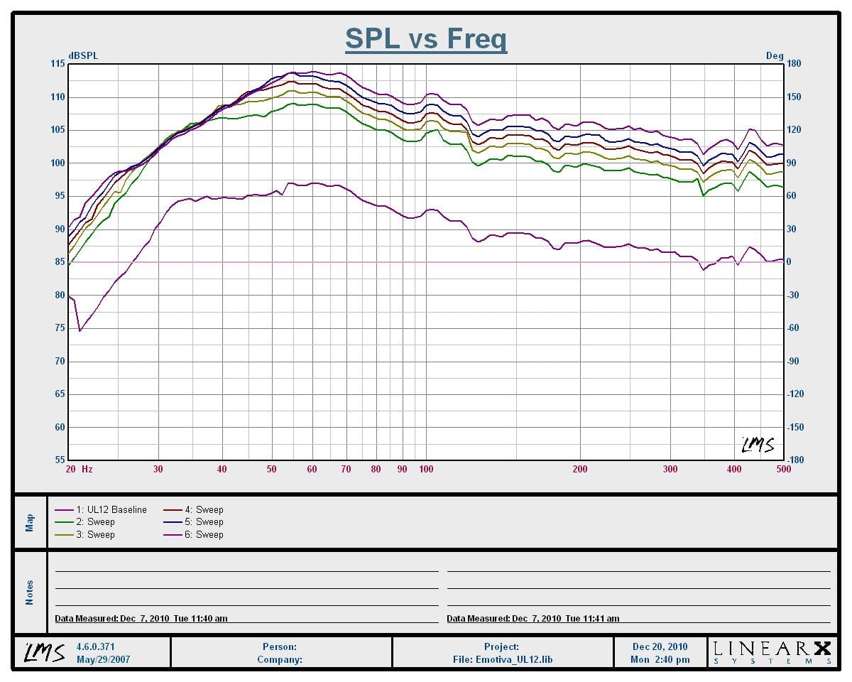

If it's anything like the last 12" emotiva sub:
http://www.audioholics.com/reviews/speakers/subwoofers/ultra-12/EMOUL12measurements.JPG/image_view_fullscreen
I'd be pretty wary on what kind of frequency response i was ACTUALLY getting. It's easy for a sub to reproduce 10hz at 60db even. The question is at what SPL does its limiting circuitry kick in? That's going to change the tonal nature of what you hear, most likely.

Sorry GranteedEV, what do I read from that graph? is the fact that the lines aren't too closely together from 20-25hz or so an indicator that the performance may be less than optimal?

It's that "it goes down to 20 Hz" but only has a flat response curve at low volumes. When you start increasing the volume, it just can't keep up on the low end. SPL at 50+ Hz scales up fairly well, but below 40 Hz the sub just lacks any linearity at all, that 20 Hz -3dB point becomes more like 40 Hz with the volume up. Tiny subs just can't do 20 Hz at volume.
