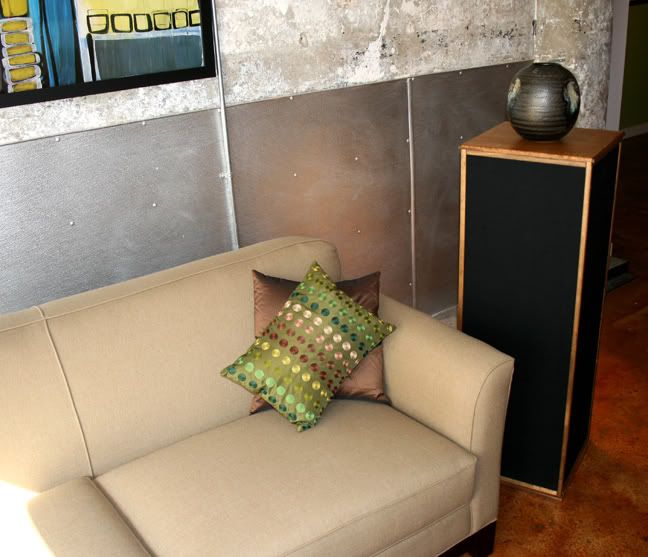

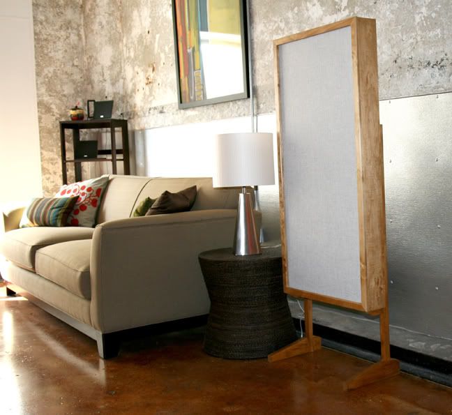

Funny you should bring this up. Last fall I was out at the Rock Mountain Audio Fest and got talking to some of the guys there about room treatment (YES AT THE BAR:D). All the guys seem to say the same thing to me "Glenn build us a product the wife will like". So when I got back we all put our heads together over here at GIK camp and came up with 2 new things, the GIK 242 Elite and the GIK Pillar Elite.
You think your wife would go for something like this?
If your good with wood working you could also build something like this.
Glenn

I like the top one, it kind of looks like a little droid, standing there. I appreciate the help though - trust me, I am way in uncharted territory here, so any help is greatly appreciated (regarding acoustics). It's merely something I have never really given much consideration to, until I started frequenting this forum and learning more and more about audio in general.
I have to admit, that I don't think the wife would really go for either one of the panels in the photos, however, with a little craftiness, I could probably put together something that would be visually appealing.
